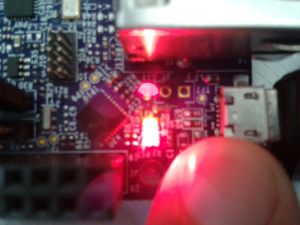

Dear,

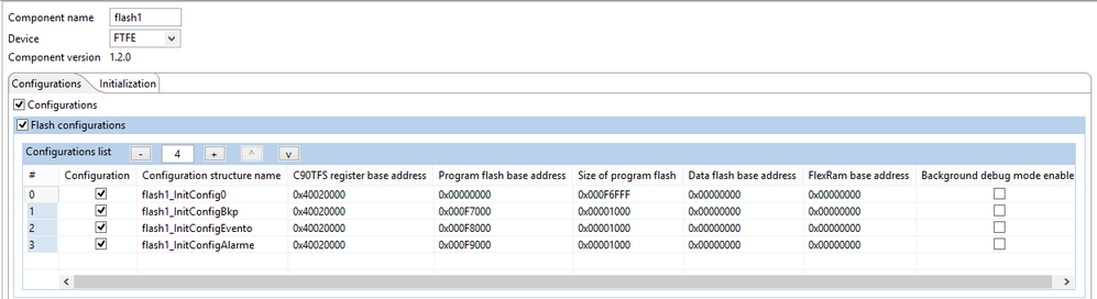

I am performing read and write operations in the flash of my FRDM-64F. Using the fsl_flash KSDK 1.2.
I created the memory areas:

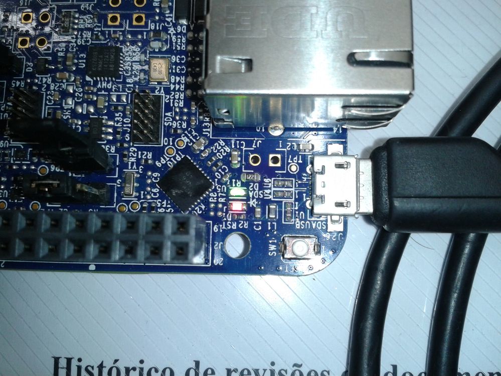

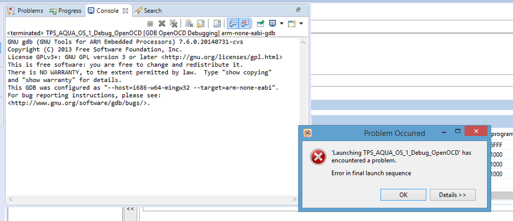

In execution of the erase flash operation. The FRDM-64F does not work anymore. Lost communication and does not accept the writing of new hardware:
The RESET LED is slightly access (apparently oscillating) and when you press the reset button it lights normally:
The event happened during debbug program in this passage:
result = flash_app_EraseSector (flash_app_destAdrss(1,&flash1_InitConfigAlarme),1,&flash1_InitConfigAlarme);

Hello Juandres M. Lazaro ,
Now please test one simple project , check whether it can debug well .
If it also not not download and debug , please update the bootloader of your board refer to the
"FRDM-K64F Freedom Development Platform -Quick Start Guide.pdf" .
I see you use the OpenOCD debug mode,  you need drag and past  the drive again to the bootloader;
or you can also use the segger jlink debug mode , you need  drag and past the "JLink_OpenSDA_V2.bin" to the bootloader .
