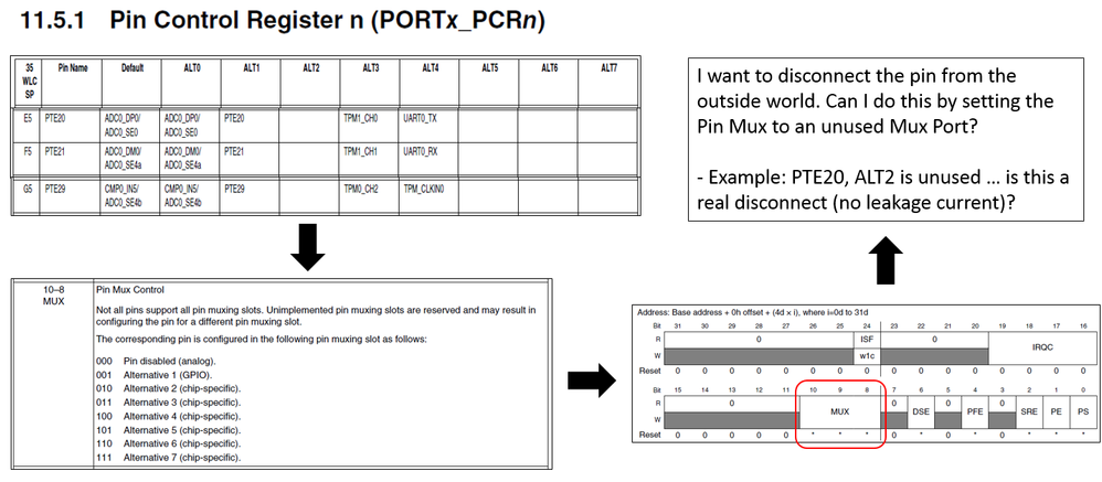

I currently disconnect a GPIO from my system (KL15) by turning it into an input, but this is sort of fake. I wish to disconnect an GPIO completely but Processor Expert (PE) does not give you this capability.
The pins shown are what I am using. The 'Pin Disable' which is likely Default (doesn't really match but likely what they mean). a disconnect unless the pin is used for analog, which in my case it is. However ALT2, ALT5, ALT6, and ALT7 are unused. Does this mean if I set the PinMux to these nodes I will be officially disconnected? This is my first question.
2nd question is the picture below. PE does not have a control for this functionality, and why not? If I dig deep enough in the driver I can see the code, but is there a different/easier/more elegant way than editing or developing my own code?

Hello Peter Twiss:
Thank you for posting this discussion. See below my answers:
1) The empty MUX options should not be used and as shown in your first picture this could have an undefined behavior:
2) You are right, unfortunately PEx does not have any API to disable pins or return to their analog function. But it is probably not required, this can be done with a simple call to one of the PDD layer macros, like next:
/* Disabling pin PTE20 */
PORT_PDD_SetPinMuxControl(PORTE_BASE_PTR, 20, PORT_PDD_MUX_CONTROL_DISABLE);
I hope this helps.
