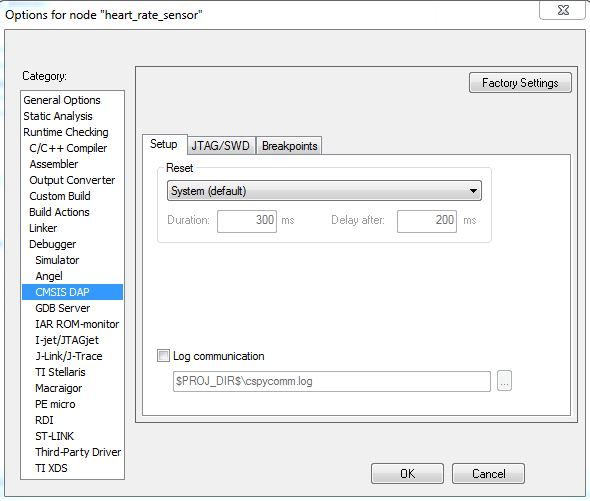

I'm working with freedom KW40Z but when you load a sample project get me the following error
CMSIS-DAP "Fatal error:CPU did not power up" ...
I am using iar 7.50 with an evaluation license for 30 days.
someone could help me
Best regards.

attached a picture to the board with the configuration of jumpers

Por fin encontré la solución a mi problema
En primera revisar que las conexiones en los  jumpers son las correctas para el tipo de alimentación en la que vamos a trabajar.
En segunda en el compilador iar forzar a un reset por software como se ve en la imagenCaptura.JPG
Después volví a descargar el programa y funciono!!!!

Thank you very much for your response Ramón.
I'd like to translate it for further reference in the future.
In IAR it is necessary to change the configuration, you just need to click in main menu on Project tab then follow Options... or Alt + F7:
You'll see the next window and you have to select as follows In Category < Debugger (CMSIS DAP) < Septup < Reset.
Then you have to select the option System (Default) then click OK.
You should download again and the problem should be fixed.
I hope this information helps.
