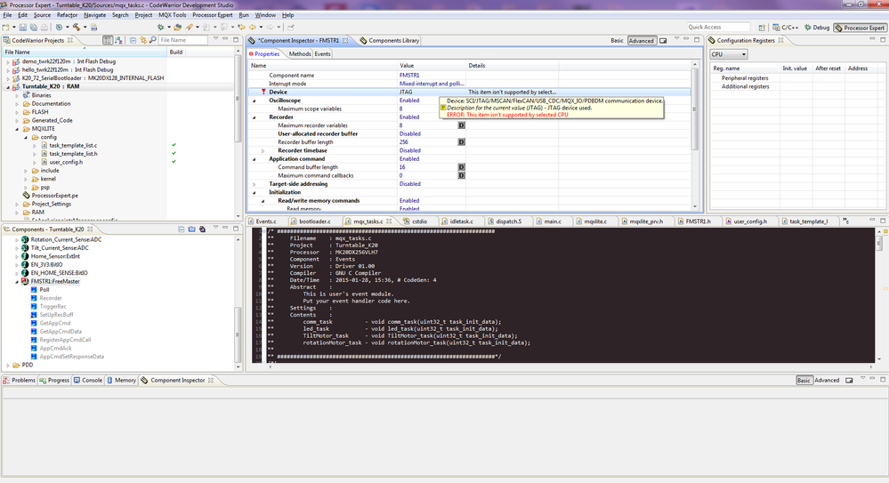

I setup freemaster via UART1 on a K20 72MHz processor and it's awesome. I followed the following tutorial:
http://mcuoneclipse.com/2013/08/24/tutorial-freemaster-visualization-and-run-time-debugging/
I would now like to try it with JTAG (since I use UART in my application). Is this possible? I currently get the following error when I select JTAG as the device in the FMSTR1 freeMaster component.
Error: This item is not supported by selected CPU.
Not sure if it is not supported or I need to enable some define somewhere. I do have JTAG on this CPU and am using it successfully.

abidesmail
Hi Fang,
Thanks for getting back to me.
The problem isn't on the Host side, it is on the device side. When I try to select JTAG on processor expert freemaster component I get a message saying ERROR: This item isn't supported by selected CPU. Please see the image below
