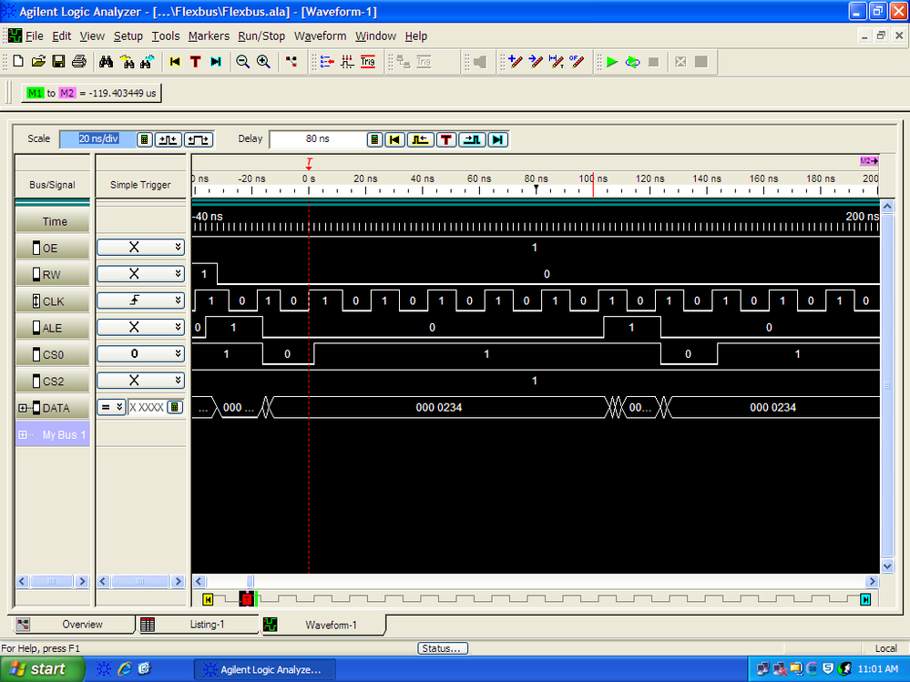

Hi! I am working Flexbus connection between mk22 micro and FPGA and trying to achieve maximum throughput in both directions. The configuration is 32 bit address and 32 bit data multiplexed, no wait states, auto-acknowledge.
First I have configured it to run at 40 MHz with core clocked at 120MHz. By looking on signals with logic analyzer I have recognized that instead of theoretical 4 cycles for read or write I am achieving only 5 cycles for read and 6 cycles for write.
When I clocked down the processor to 100 MHz and Flexbus speed to 50 MHz it runs 6 cycles for read and 7 cycles for write.
I have also confirmed that control register values are what I expect them to be.
Any consideration why this would be happening?
Addition: while running at 40MHz/120MHz if I add 1 wait state it runs at 5 cycles read or write (as expected).
Thanks!

Could you provide the Flexbus register configuration and logic analyzer signal scope pictures?
The Flexbus clock could up to 50MHz.

If you could provide the test code?
From the logic analyzer signal, after the Flexbus doing the 32-bit write, then it waiting for the instruction(code execution) to start the next 32-bit data write.
Customer could try with the burst transfer mode, there could do 16 byte burst transfer to enhance Flexbus performance.

The test code could not be simpler:
for(n=0x0000;n<0x00400;n+=4)  //address offset
  *(vuint32*)(&MRAM_START_ADDRESS + n) = 0x1234;  //write
With DMA it managed to write first value in 4 cycles and following in 6, which is obviously better, but still not 4 cycles constantly.
What is your estimation for burst 16 bit writes? 5 cycles?
Thanks, Viktor

Hui_Ma
The burst 16 bytes (one line) data read just need using 7 cycles and write need using 8 cycles for 32-bit port.
