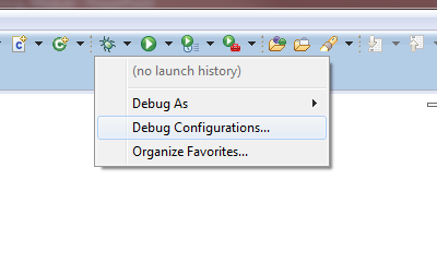

  3. then go to KDS  to the debug icon > debug configuration.

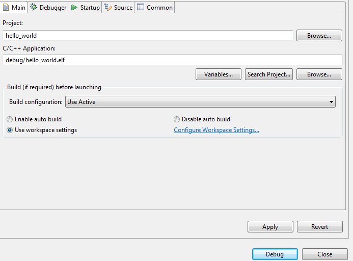

  4. In this window please double click on the configuration you have for example my device was recognized as JTAG so ill double click on the Jlink debugging pastedImage_4.png
  5. the browse for your project location. and the application (.elf) to be uploaded to the MCU. on your project folder go to debug folder and when you build it will generate a .elf file with the name of the  project like thispastedImage_5.png
  6. apply and debug or apply and close
  7. now you will have a configuration for your  MCU and you should be able to debug it.
