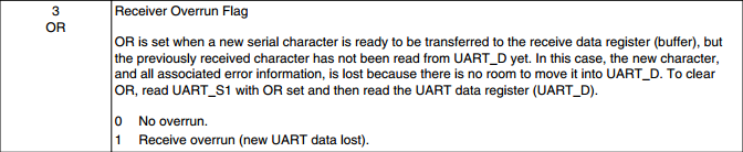

    I want to know what is the best way to handle Uart Rx Overrun Error in KEA-128??? what are the conditions it will happen and how to handle it?

 The OR flag will tell you when you overrun on the UART. I recommend to  have a buffer to save the information before you process you information to prevent the information lost in case you overrun the UART buffer. you can set an interrupt to this flag to know when this is happening. in the reference manual there is   the table where I found this information (section 33.3.5).
