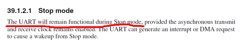

Hello Vipin,
Yes, the UART0 can also work in the Low power mode , please see the Reference Manual :

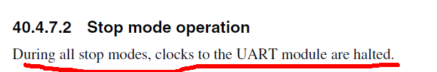

And the uart1 and UART2 are not work in the low power mode :
Alice Yang
