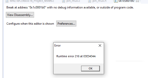

I am having a lot of difficulties to start programming with the MKE18F256VLH16 microcontroller.
I'm using MCUXpresso 11.1.0, SDK 2.7.0,  and a PE Multilink tool to SWD debug.
The board was assembled by me, and it is a simple flash LED, and it build fine. The first time the download program run successfully, but at all other times it didn't.
The microcontroller yet has been replaced, and it continue always lock at debug
99%, showing an error message: Runtime error 216 at 03E3434A:

Calculated CRC-16 does not match block. (File = $DCD9, Device = $5598)
Current content of flash does not match application to be programmed
CMD>EM
Erasing.
Module has been erased.
Reloading programming algorithm ...
Error Erasing flash of device
Error occured during Flash programming.
PEmicro GDB Launch Failure : Error during flash programming. Terminating debug session.
Can anyone help me?

engenharia
Hello Sabina, how are you?
After many tests, I saw that the defect was in the P&E multilink, I needed to update the device and it started to work.
Thank you
