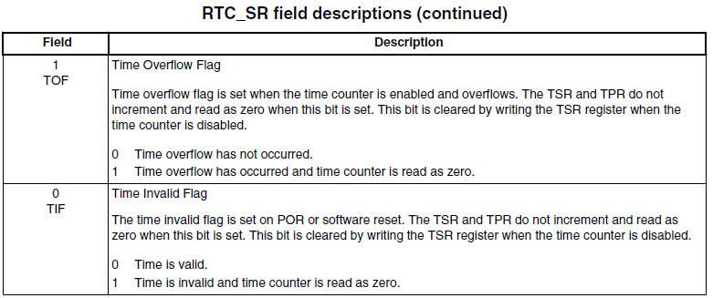

Hi!
I'm trying to read the RTC Time Preacaler Register, but it only returns zeros. I'm setting SR[TOF] and SR[TIF] to zero to avoid this problem, but this have not been effective.
Below, my code:
void RTC_init (void){
  SIM_SCGC6 |= (SIM_SCGC6_RTC_MASK);
  RTC_SR |= (RTC_SR_TCE_MASK|~RTC_SR_TIF_MASK|~RTC_SR_TOF_MASK);
int RTC_counter(void){
  return RTC_TPR;
Anyone knows where is the error?
Thanks in advance,
Rafael

Hi Rafael
The TOF and TIF bit are read only, see the RTC_SR field descriptions.
This bit is cleared by writing the TSR register when the time counter is disabled.

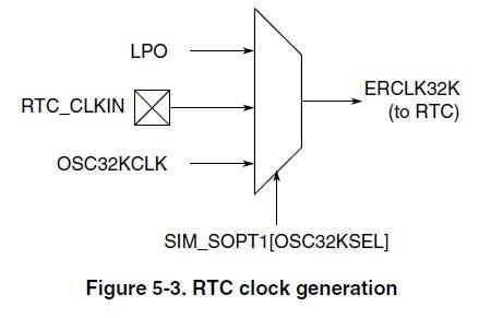

And make sure the clock source you selected is active.
