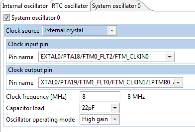

I believe I found the problem, and it found in the CLOCK_SYS_BootToPee function inside fsl_clock_manager.c at this point in time:
    // First prepare the external OSC clock.
    CLOCK_HAL_PrepareOsc(MCG, oscsel);
    // Set to FBE mode.
    CLOCK_HAL_SetClksFrdivIrefs(MCG, kMcgClkOutSrcExternal,
                                     config->frdiv,
                                     kMcgFllSrcExternal);
    while (kMcgFllSrcExternal != CLOCK_HAL_GetFllSrc(MCG)) {}
The lock up occurs because their is a synchronization issue, or IREFST in MCG_S is just not being updated.  With a breakpoint set on CLOCK_HAL_SetClksFrdiveIrefs, you can see that MCG_C1_IREFS = 1 and MCG_S_IREFST = 1.  When CLOCK_HAL_SetClksFrdiveIrefs is executed, it clears MCG_C1_IREFS (to 0) and in a working scenario, MCG_S_IREFST also gets cleared to 0 (MCG_S = 0x0A), and the user application runs as expected.
In the locking scenario, after CLOCK_HAL_SetClksFrdiveIrefs is executed, MCG_C1_IREFS is cleared (to 0), however MCG_S_IREFST does NOT get cleared (EVEN THOUGH MCG_C1_IREFS IS 0!), so MCG_S = 0x1A, and that is why it is locking up on while (kMcgFllSrcExternal != CLOCK_HAL_GetFllSrc(MCG)) {}.
In other words, my results show that the issue is hardware related (MCG_S_IREFST doesn't properly reflect MCG_C1_IREFS because of a synchronization error).
