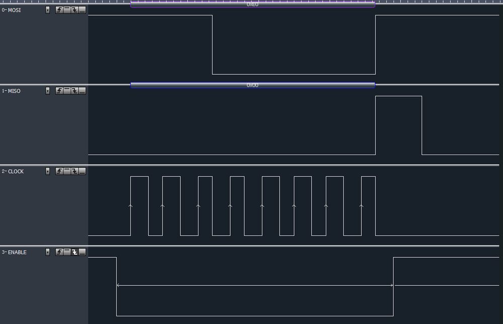

The SPI interface chip and external I use MKL05Z32 MCU communication, MKL05Z32 communication as MASTER, peripheral chip as the slave, SPI driver is used in the http://cache.freescale.com/files/32bit/software/KL05-SC.zip in the SPI driver, but cannot read the peripheral chip return data, using logic analyzer to obtain the following graph. Excuse me for how to configure SPI interface to get numerical peripheral chip.
Why can not read to return the value of the peripheral chip is CS signal and Clock signal disappears error.

Problems found, the reason is the chip selection signal (CS=0)  provided by the SPI interface provided by Freescale after the start delay for a very short time began to send commands, and peripheral chip is selected needs to wait for more time to accept commands, so the cause can not be normal communication, suggested that Freescale add a register, the user can according to the use of the chip free definition of delay time.

Hi Thooman Wang,
Do you mean the delay time between the chip selection signal enabled (CS=0) and send command is too short, then cause the device couldn't accept command correctly?

Contributor V
Yes, kl05 chip using SPI communication, the system settings after CS signals can transmit data, effective to transmit data between the CS signal from the time interval is too short (only about 5us), and I use the chip (SPI Slave) requires at least 15 US, this is why I had always communication failure.
