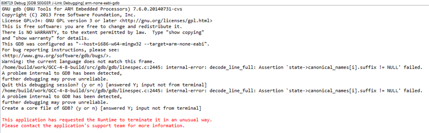

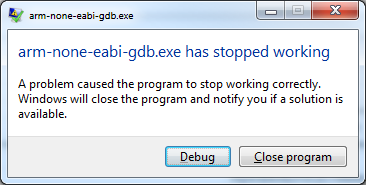

I've run into an issue after updating the firmware in my J-Link Ultra+ to the newest revision. Now, when debugging, arm-none-eabi-edb.exe crashes almost immediately, ending the debug session.
Target processor: MKV31F128VLH10 (64-pin LQFP)
Above: the error message
Above: arm-none-eabi-edb.exe console, which also reports an exit value of 255

Shout-out to my FAE, Norm Siegel. He pointed me to this post from Erich that turned out to be the source of the problem:
Failed to Debug with GDB: Breakpoints or Expressions on non-existing Locations | MCU on Eclipse
The J-Link firmware update was just a red herring.

BlackNight
Hi Lee,
yes, this is a long standing (and nasty) but of GDB. Later versions of the GNU for ARM Embedded (launchpad) tools have that one fixed. You might consider to use the 4.9 toolchain instead (I have it side-by-side in KDS), see Using Kinetis Design Studio V3.0.0 with the Launchpad 4.9-2015-q2 Release | MCU on Eclipse
I hope this helps,
Erich
