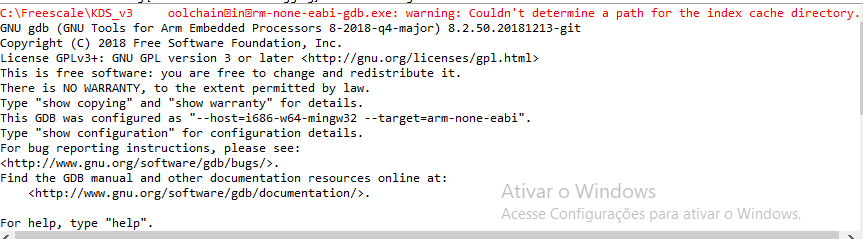

arthurpassos
Ok,
According to my console it's using the newest version:
Should I be worried about that warning?
It increased 30k on the .bin size and consumed 2k more on the heap (I was with 17K free and now I get only 15K free).
Is there something I could do about it? Also, where can I set the language standard (c++14 or c++17, for example).
Thanks, Erich.
4,430 Views
BlackNight
Hi Arthur,
that list with compiler options is part of the GNU MCU Eclipse plugins (see Downloads ). Regardless, you can specify additional options in the miscellanous section. pastedImage_3.png
So you are not missing anything. If you want or need an extra entry in the dropdown, I suggest you log it here: Issues · gnu-mcu-eclipse/eclipse-plugins · GitHub
About that console message: it looks it is an issue in the most recent gdb, see that thread here:
Debugger plugin issue when I click the "Setp into instruction"
I hope this helps,
Erich

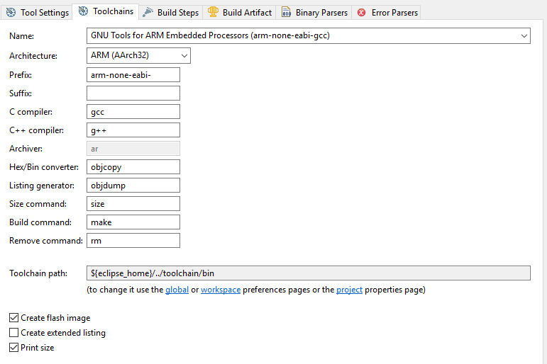

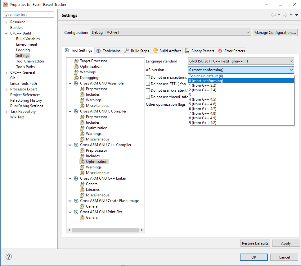

arthurpassos
Hi, Erich.
I followed your guide and there doesn't seem to have a problem except that under project properties -> C/C++ Build -> Settings -> Tool Settings -> Cross ARM GNU C++ Compiler -> ABI Version I can't find a newer G++ version, it doesn't seem to have changed anything. Please correct me if it's not where i should be checking/ changing my compiler version.
I checked the path, it matches and the version of the compiler has actually updated:
Which seems to be updated, right? (the previous gcc reported 4.x).
Is there something I'm missing?
Thanks.
