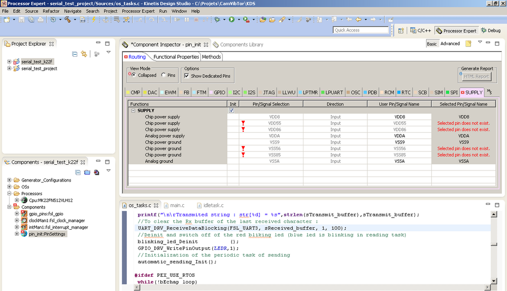

rémiraynaud
Thank's carlos,
But I necessarily have to make my project with SDK 1.0.0.
I uploaded processor expert patch for k22f.

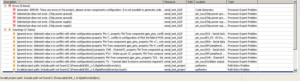

Now, I haven't the last PEx problem yet. But when I add MQX_KSDK and OS_TASK to my project, other errors appear :
DescriptionResourcePathLocationType
ERROR: Project doesn't contain "OS_Task" component. Please add the OS_Task component to the project.serial_test_project_k22f_ksdk1.0mqx_ksdkProcessor Expert Problem
ERROR: Component does not support Kinetis SDK API version.serial_test_project_k22f_ksdk1.0choice_test_taskProcessor Expert Problem
Generator: ERROR: There are errors in the project, please review components configuration. It is not possible to generate code.serial_test_project_k22f_ksdk1.0Code GeneratorProcessor Expert Problem
There are any other patch to upload for processor expert and the k22f?

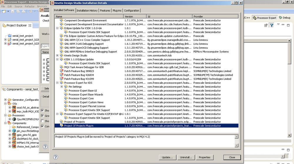

rémiraynaud
Look at my installed software
thank's for your help
