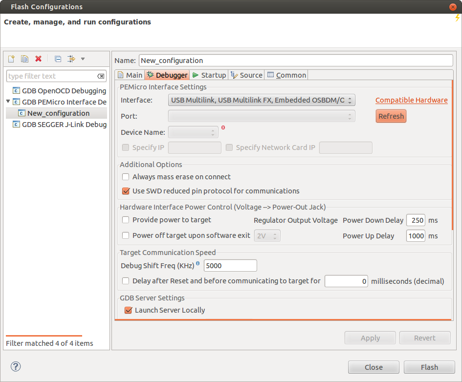

With P&E plugin 1.1.6 we allow user to specify a path to location of his GDB server by going to Debug Configurations -> Debugger -> GDB Server Settings -> Executable
In some instances, this path gets corrupted, which is when P&E plugin looses ability to detect hardware interfaces and/or device selection. If you are observing this behavior, as a workaround, please follow these steps:
1. Create new P&E debug configuration by going to Debug Configuration menu and right click to create New configuration under GDB Pemicro Interface Debugging.
2. Go to Debug Configurations -> Debugger -> GDB Server Settings -> Executable and Browse to point to a valid GDB server path within your KDS 1.1.1 layout. You will most likely be able to find the latest P&E plugin installed at the following location: C:\Freescale\KDS_1.1.1\eclipse\plugins\com.pemicro.debug.gdbjtag.pne_1.1.6.xxx\win32\pegdbserver_console.exe
3. Once this is done, you will be able to select corresponding Kinetis device and your Multilink interface under Debug Configurations -> Debug configuration tab of your project.
Please let me know if you are able to resolve the issues you are seeing with P&E plugin 1.1.6 following instructions above.

tivadar
Hello!
I have the same problem too. I use KDS 1.1.1 on Ubuntu 12.04 32 bit. I have the latest P&E plugin (1.1.7) and KSDK.
Until this version of the plugin, there were the same problem as samsaprunoff described in his original post. After the update the KDS simply does not find the my TWR-K70F120M board.
With lsusb I can see the device in Linux. What could be the problem?

So... I spent more time on this today...  Firstly, I wanted to confirm that my target board and Universal Multilink (UM) where working OK and so I tried using the same setup with my licensed CW 10.x versions... Sadly, none of them cannot seem to connect to my target.  However, within the CW10.x the debugger setup it can "see" my UM on my USB port... it just simply cannot connect to my target.  I then checked the continuity of the 20-pin ribbon cable and all was fine here.  I examined it under an inspection scope and again no issues could be seen.  I then created a bare-board project under CW 10.x and I had the same issue.  I tried on a few other different boards (same processor) and the same issue was occurring.  So, my next step was to install CW 10.6 on a different computer and try it.  I did this and verified that the UM USB Drivers were the same ... and they were...  With this new computer and I can connect and debug my targets fine... now I have confirmed that the target(s) and the UM are working fine.
I now go back to my work computer and unistall both KDS and CW 10.6 and reboot the computer.  I re-install CW 10.6 and try again to connect to my target...  Sadly, as before, I cannot connect to my target board.  I try other CW 10 versions (10.2, 10.5) and the same result... my main work computer cannot seem to connect using the PeMicro UM... this is not good.
Now I reinstall KDS (1.1.1) that I downloaded on Oct 10, 2014.  Once completed I created a bare board project and try again to connect to my target.  I noticed immediately that KDS can now "see" my connected UM on my USB port and it fails the first time to connect.  I reset the target and try again and I could now connect to my target.  That being said, this is where I was before where I would get "remote connection errors"... however, at least I can connect to my target periodically.  Upon review of the console the PEMicro Plugin is the following:
CMD>CM C:\Program Files (x86)\Freescale\KDS_1.1.1\eclipse\plugins\com.pemicro.debug.gdbjtag.pne_1.1.2.201408071632\win32\gdi\P&E\k60dn512z_pflash_pipeline.arp
So... it would appear that the 1.1.6.201409261701 version is a problem for my system... I will certainly not update this plugin unless PE instructs me accordingly.  However, I am at a loss as to why the 1.1.6... update knackered my CW 10.x debugging...
