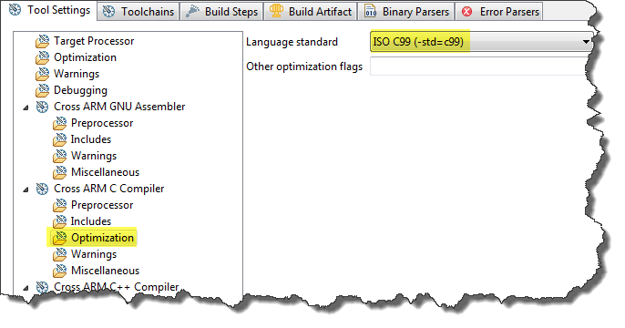

At present fighting the more interesting porting problems:
1) I've got a UART in there turned on and it's missing a define (SIM_PDD_PLL_FLL_CLOCK) that I haven't tracked down.  PE generated library code won't compile.
2) There is a worrying warning that asm() is being treated as an implicit declaration.  IDE shows it as a keyword but it's still bitching about it.
8,556件の閲覧回数
BlackNight
Hi Randy,
1) I think it is this issue: https://community.freescale.com/message/401739#401739
2) by default, the projects are using C99:
You can consider to change it to 'Toolchain default (GNU ISO 90), but as Mark says, that's probably not what you want.
Instead, it is probably best if you simply change asm(...) to __asm() (with two underscores).
Erich

randylee
Contributor V
Forgot that was documented at the top.  The easiest thing for me to do is to change the call.... Not a problem.
the UART thing is a little interesting.  Yes, this particular project was started on a KL25 FREDM board and then ported to a KL15 in preparation for the Real Thing.  I'll drop down that path and see what I see with it.
thanx
rjl

mjbcswitzerland
Specialist V
Randy
The asm() point is detailed above. Either change the compiler setting or (preferably) modify to __asm__()
regards
Mark
