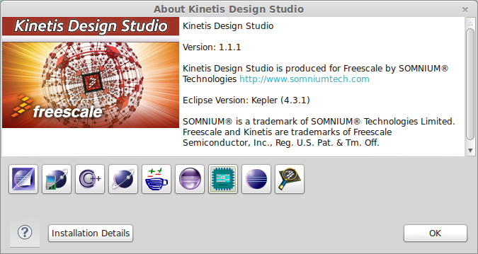

Here are the KDS and PE versions:
and KSDK used is 1.0.0.

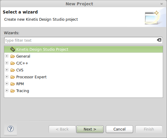

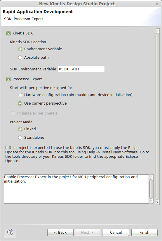

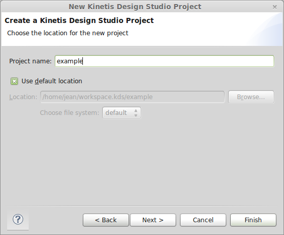

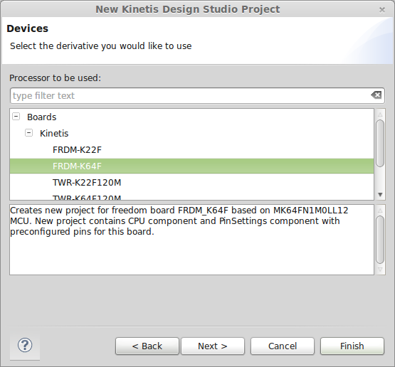

I create a brand new project with the following steps:
14533_14533.pngexample_01.png14534_14534.pngexample_02.png14535_14535.pngexample_03.png
For the last step, I decide to include Processor Expert, so I can add some of the components (like an RTOS):

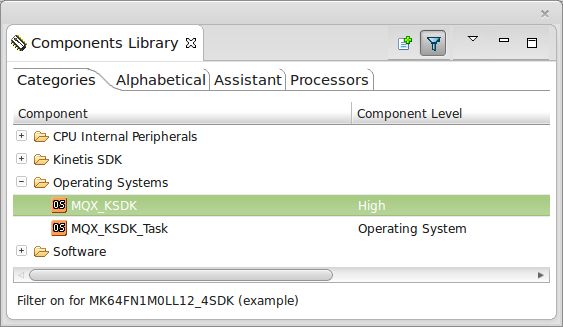

Next, I want to add an RTOS to my project. So in the Hardware perspective, I click on the "Components Library" tab and select the MQX_KSDK under "Operating Systems". By the way, I couldn't possibly see a way to add FreeRTOS at this stage. Why ?

     Firstly, add the "MQX_KSDK_Task" commponent.
     Then,  delete the unused cpu clock model.  look at the attachment.
