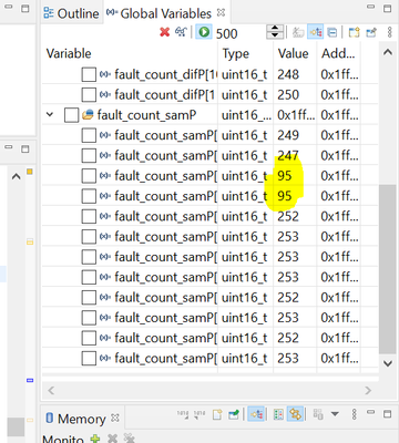

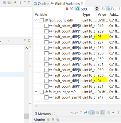

After either of the above fault detection functions are called, the Fault counts are stored in a array
fault_count_difP[]
fault_count_samP[]
User can see the reduction in counts at the respective LCP pin index in the fault_count_difP[] & fault_count_samP[] array when those pins are shorted.
Following is the screen shot of the same when LCD pin 59(BP) is shorted with pin43(FP)
When Pin 59(BP) is shorted with Pin60(BP)
