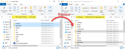

You don't want to open the "lvgl_guider" example project with GUI Guider. This example project is just a template for any LVGL/GUI Guider project, in MCUXpresso.
What you want to do is have the "lvgl_guider" project in the IDE, then separately create a GUI Guider project for the same board/MCU, and once you are done creating your GUI, override the "custom" and "generated" folders from the GUI Guider project with the template "lvgl_guider" MCUXpresso project.
In other words, you are just passing the actual GUI that you created in GUI Guider to a 'base' or 'template' project in MCUXpresso.

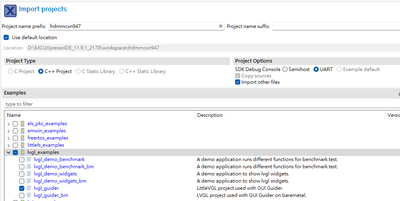

We don't have any documents that describe the process of adding USB HID communication to a GUI Guider project. Your best bet would be to import both the "lvgl_guider" example code, as well as a USB HID example code of your choosing, and merge them into a single project. I would migrate the USB HID into the lvgl_guider one, instead of the other way around. Then, you can open GUI Guider, create your GUI, and build it. Finally, you would replace the "custom" and "generated" folders from your MCUXpresso project, with the "custom" and "generated" folders of your GUI Guider project.

First, import "lvgl_guider" example code on MCUXpresso.
But I don't know how to open this project on GUI Guider.
