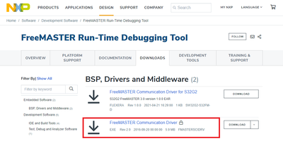

Hi @Ch1,

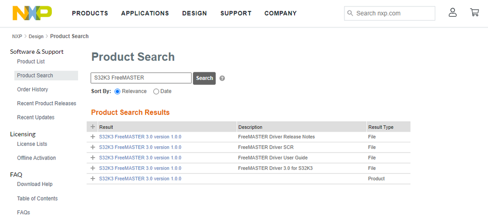

Are you referring to this FreeMASTER Communication Driver from the download page or S32K3 Update site ?
The first one (picture below) is for older K1 MCU family.
Soon, there will be a separate (K3 specific download link, similar to G2). In the meantime, could you please check if you can find FreeMASTER package for K3 in your product lists.

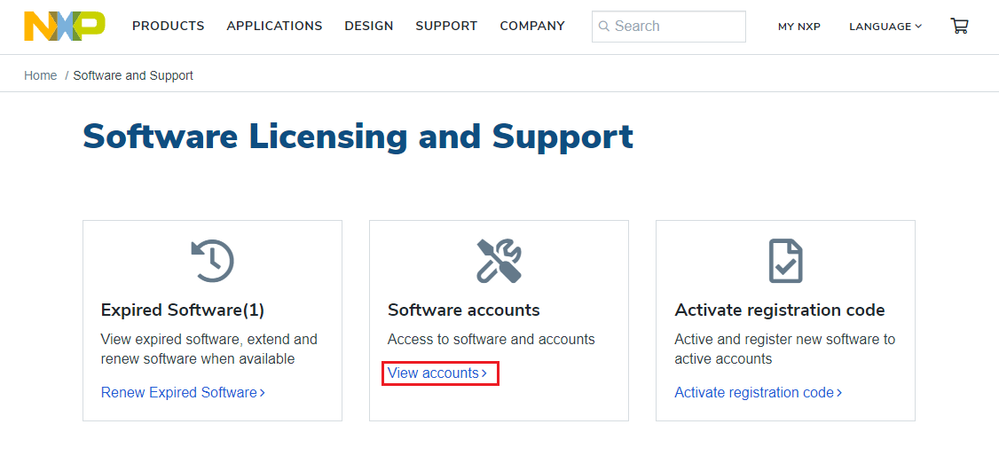

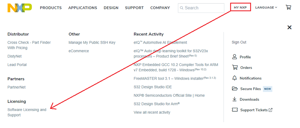

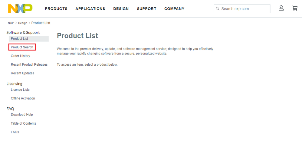

You can access it from NXP home page:
MY NXP → Software Licensing and Support →  Software accounts → Search Product (search for "S32K3 FreeMASTER").
S32K3 FreeMASTER package includes:
  • Release Notes
  • S32 Design Studio update site (contains FreeMASTER SDK/Driver for K3)
  • User Guide
Release Notes include Update Site installation steps and the User Guide describes Driver configuration options.
In case you can not find it, I attached an archive with those files (this a temporary solution and I will post an update in this thread once a download link is available on FreeMASTER home page).
To answer your question - once you have the update site installed in S32 Design Studio you can create a new project or attach FreeMASTER SDK to your existing project (see Release Notes). From that point can follow the same steps I described in my other reply from the thread.

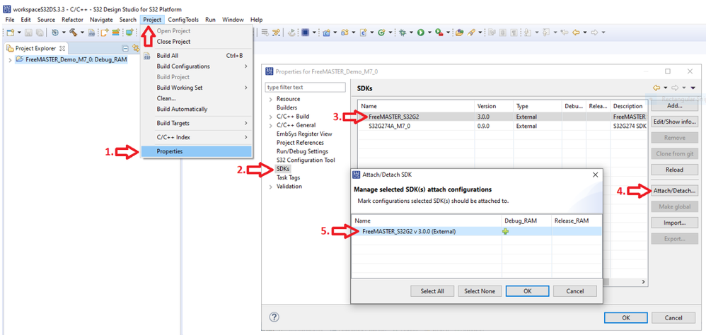

iulian_stan
When you attach the SDK, S32DS will automatically include all FreeMASTER source files (this one shows G2 but should work the same way for K3):
After the SDK is attached it should automatically open "freemaster_cfg.h" (FreeMASTER configuration header file), in case it does not open - you can find it in freemaster_include folder in your project tree.
By default, it is configured to work in UART mode:
//! Select communication interface (currently only serial is supported)
#define FMSTR_TRANSPORT         FMSTR_SERIAL                    // Use serial transport layer
#define FMSTR_SERIAL_DRV        FMSTR_SERIAL_S32K344_LPUART     // Use serial driver for UART
You can add this files manually as well - all source files can be found in C:\NXP\S32DS.3.4\S32DS\software\FreeMASTER_S32K3_v3\src.

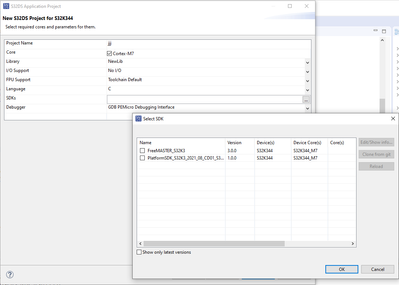

JoDo
you can do this when you create a new project by selecting the FreeMaster SDK additionally (see picture).
But here is a better guide:
https://community.nxp.com/t5/S32K-Knowledge-Base/How-to-use-FreeMaster-SDKs-in-S32K3-RTD-0-9-0/ta-p/...
