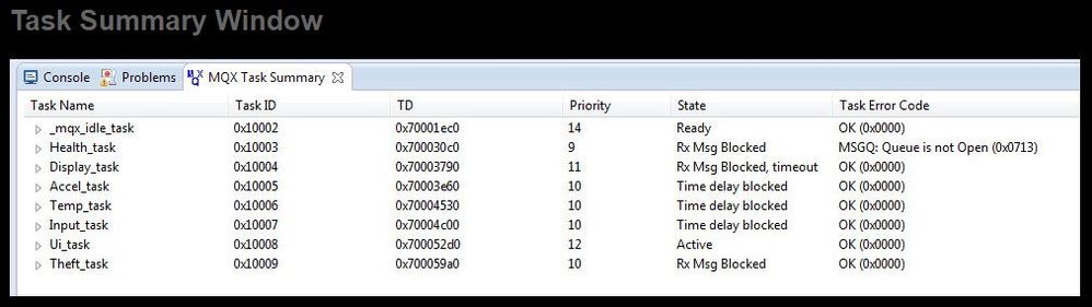

    1. Click on the MQX pull down menu and select the Task Summary from the MQX pull down menu. The task summary list should appear. Confirm that the tasks listed by name is the correct set of tasks for your project, check that the priorities are correct, note the various states that the tasks are in, and observe if any of the tasks have an error.
      Note that the Health Task has an error "MSGQ: Queue is not Open." This will be investigated later in the lab.

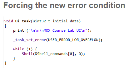

    2. In order to quickly observe that TAD will acknowledge this new error, open Uitask.c and force this error condition using the _task_set_error() function before the while(1) loop.
    3. Compile and run the application code for a few seconds. Pause the application and observe that the Ui_task has an 'Unknown error (0xffff0001)' listed in the 'Task Error Code' column of the 'Task Summary' window.

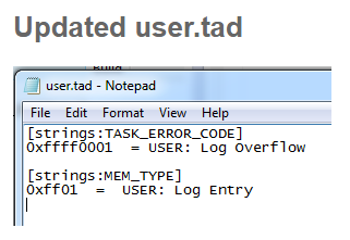

    5. Open this location in Explorer and create a new text file called 'user.tad' in this folder. Open the new file for editing and enter a title at the top that indicates that this file is an extension of the error codes and then enter the new error code with its definition.
      [strings:TASK_ERROR_CODE]
      0xffff0001  = USER: Log Overflow
    6. Save the new file, terminate the application (if it is still being paused), compile, and then run the application for a short period. Now observe the 'Task Summary' window to ensure that the new error code shows up for the Ui_task.

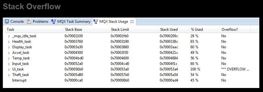

    1. Open the 'Stack Usage' window and observe the amount of the stack that has been used for the Ui Task under the '% Used' column.
    2. Open main.c and in the Task Template List change the amount of stack space allocated for the Ui Task to be just slightly under the amount being used. For example, if 54% of the stack was being used previously (which is 810 bytes of the 1,500 bytes allocated), then set the stack size in the Task Template List to be 800 bytes. Note that if you reduce the stack size too much there will likely be a crash of the application due to corruption of the memory that the stack for the Ui Task is overwriting.
    3. Terminate, compile, and briefly run the application. Ensure that an overflow is indicated for the Ui Task on the 'Stack Usage' window.

    1. Open the 'user.tad' file that was created in step 11 and add an extension to the memory string types listing to include one for Log Entries. Note that memory type values are 16 bit, not 32 bit. To avoid a conflict with currently defined memory types, start with a value of 0xff01 or higher.
      [strings:MEM_TYPE]
      0xff01  =  USER: Log Entry

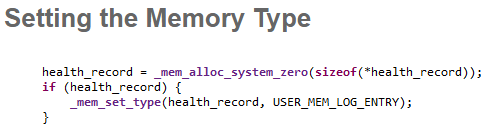

    3. Open the code for the Health Task and locate the _mem_alloc_system_zero() function call that is used to allocate memory for a new log (when processing messages of type 'LOG_TICK_MESSAGE'). If memory was successfully allocated, set its type to 'USER_MEM_LOG_ENTRY' using the _mem_set_type() function.
    4. In the initialization section of the Health Task use the same code for setting the memory type after the memory for first health record is allocated.

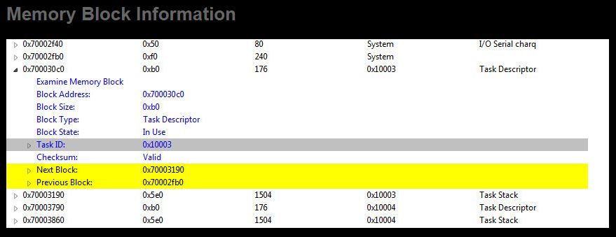

    7. Note that memory blocks can be expanded to get some additional information. Click on the '+' icon to the left of the address column for memory blocks of different types, as designated in the 'Type' Column. Part of what is shown is the block type, and if this block type references a TAD component, you can get further information on that component. For example expand a Message Pool Summary or Task Descriptor memory block.

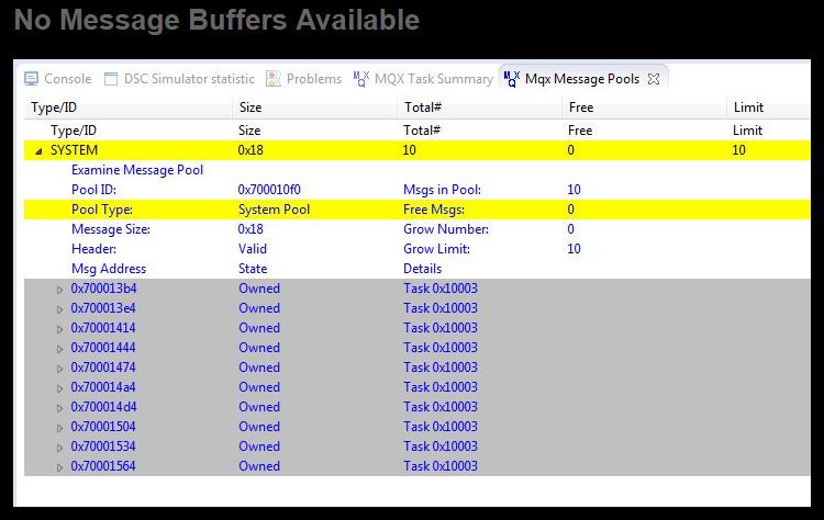

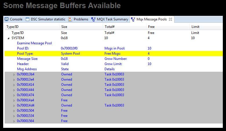

    4. Open the 'Message Pools' window. Click on the '+' to expand the details for the System Pool. Since the Health Task is not freeing up the message buffers when the tick messages are received, you should notice that the first group of buffers in the pool are 'Owned' and towards the bottom of the pool they are 'Free'.
    5. Run the application for a little while longer and then observe the System Pool. You should see that all of the buffers now are 'Owned'.

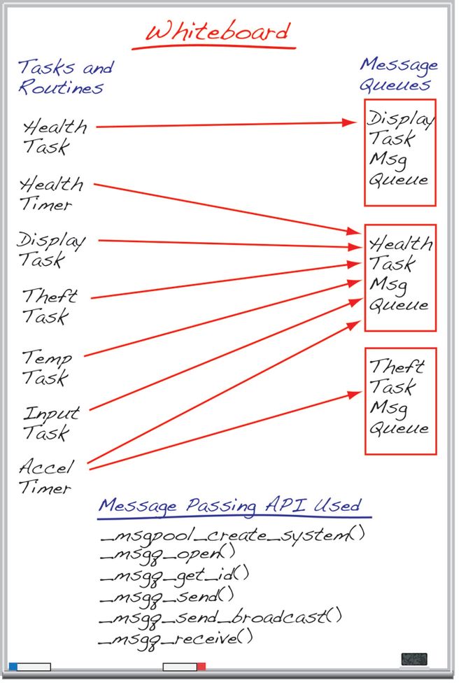

  5. Your job now is simply to figure out what the problem is that has caused the 'Queue not Open' error to occur. Yes, this is always much easier to say than to do, but a methodical approach of how your system runs and the order that things should be done in is generally a sound practice. The debugging process was started in the video and really you just need to continue along this trail, though perhaps not in so much detail. The whiteboard pop up below gives you a diagram that defines which tasks send messages to each of the message queues. It also lists the Message Passing API calls that are used in our application to help you identify what could be wrong or missing. The remaining steps of this lab will guide you through this thought process, and eventually it gives you the answer, but you are encouraged to at least make an attempt at this. Think about how you'd go about debugging this scenario if it were your own application and you had to solve this before you could progress with your development.

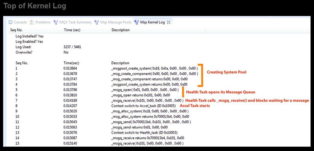

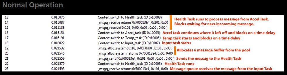

  6. Open the 'Kernel Log' window. As mentioned in the video, the Health Task would have started running first as it was the highest priority autostart task in the application. You should see in the log that the first thing done is to create the message pool. After that the Health Task's message queue was open, and then the _msgq_receive() function was called so the Health Task will block waiting for a message to come in.

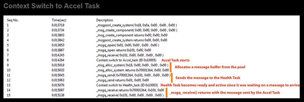

  7. The Accel task starts to run (context switch to Accel Task), it allocates a message buffer, and then it sends its message to the Health Task. Since the Health Task was currently blocked waiting for a message to arrive in its queue it will become ready to run and, since it is the highest priority task, it then immediately become the active task (context switch to Health Task).
  8. You should see some context switches; (Accel Task, Temp Task, and Input Task). The Input Task allocates a message buffer, sends the message to the Health Task, and the Health Task immediately becomes active to read its message. So far so good - this all looks normal.

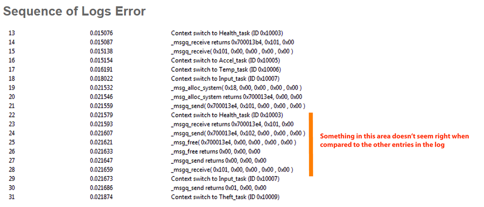

  9. By now you are getting a sense for the message passing interaction. Look a bit further down in your log and look for a sequence of logs relating to sending and receiving messages that doesn't make sense. The cheat pop up below will identify the area that is suspect. Look for yourself though before opening the cheat or reading further.
  10. In the sequence of logs identified, the Health Task is trying to send a message to a message queue but it cannot reach that queue. Since the message cannot be sent the message buffer is freed up. This is where the error we saw in the Task Summary Window is recorded. So why would you think that the receiving queue is not reachable, and what can be done about it?
  11. Answer: See the Cheat above for the reason why this is happening. One way to prevent it from happening is to have the Display Task send a message to the Health Task when it starts up to announce that it is up and running. Also, the Health Task shouldn't send any messages to the Display Task until it is confirmed to be running. The completed source code has this solution implemented so you can reference the relevant areas of the Health Task and the Display Task.
