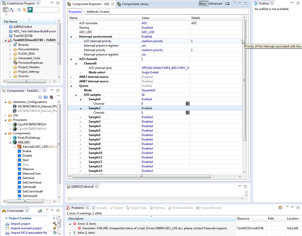

Hi All,
I am getting an error when adding more than 7 samples to the Samples list on a project with a MC56F82748 processor.
This is for a project using the High Level ADC driver.
It compiles without error if I only have 6 Samples enables in a sequential scan.
I tried creating a new project with just the ADC High Level driver and it will only compile with 1 or 2 Samples enabled but if I add a 3rd it will give the same "Unexpected status of script" error ("Generator: FAILURE: Unexpected status of script: Drivers\56800\ADC_LDD.drv, please contact Freescale support. TestADCDriver82748  AdcLdd1 ".
I added some screen shots below.
I found similar "Unexpected status of script" problem reports but not for the ADC.  A lot of them seem to be related to CW 10.6 updates which I have not done.
Any help is appreciated.
Thanks, Pete

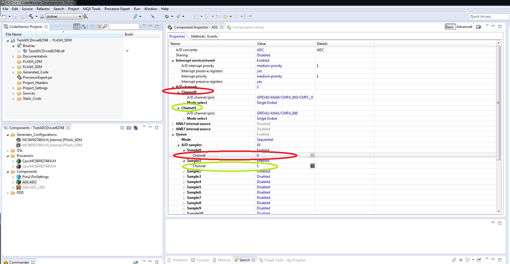

Regarding your question, I have compiled your project. I duplicated your issue, regarding the error, you have to match the channel indexs in "A/D channels" with the channel indexs in Samplex. After I change the Channel index from 1 to 0, it is okay.

Your results got me thinking and the actual BUG in the PE compile is due to the way it is handling the Number of A/D Channels versus the Number of A/D Samples as follows:
There should be no relationship between A/D Channels and A/D Samples exept that the A/D Samples 'Channel' field cannot contain a Channel Number that is greater than the 'Number of Channels - 1'.
PE is forcing you to add an A/D Channel for each A/D Sample and that is not a requirement of the ADC Module. You should be able have just 1 A/D Channel and 16 A/D Samples and all those samples have 0 as the channel number.  The Samples can be set up to any combination of channel numbers, could have 3 channels and 6 samples and repeat the 3 channels twice in the samples.
This is a PE Bug that I hope you can report and get fixed for future users.
For a temporary work-around for others, you can add the number of channels for the number of samples that you want and just set the excess channels to some used or unused input.  Then you can set the samples to any combination that you need.
Pete
