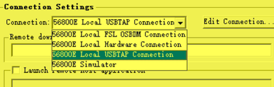

Of course, you can write a bootloader via JTAG with codewarrior for DSP56800E V8.3, but the codewarrior for DSP56800E V8.3 can NOT work on Win 10, you have to get a PC with Win XP.
For the codewarrior for DSP56800E V8.3 tools, you can only use USBTAP to download bootloader to flash via jtag, then use serial port to download application code.

Thanks for support. We are able to program the MCU via Multilink Universal & progdsc.exe. Few queries though:
