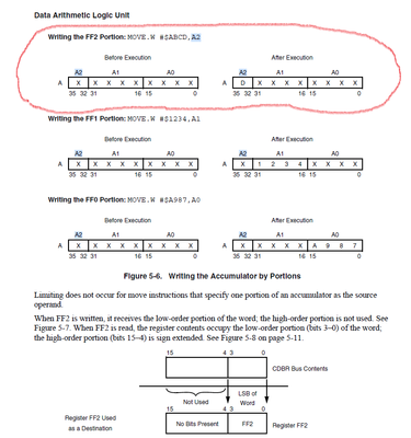

It is an "optimized" triple right shift of a 64bit unsigned value, but when clearing the accumulator extension register, the generated code clears the whole 36bit accumulator:

Notice what happens at offset 0x0000003B:
instead of emitting an error because instruction move.w #0,B2 (clear upper 4bits of 36bit accumulator B ) DOES NOT EXIST, or replacing it with the functionally equivalent clr.w B2 ...
the inline assembler emits move #0,B clearing the whole 36bit accumulator B.
The obvious workaround is to use clr.w, but NXP personell working on DSC's compiler should give a look at the root cause of this bug, maybe it's a symptom of worse bugs still lurking around in the inline assembler.

I am sorry for misunderstanding you, this is a bug of the compiler.
The assembly move.w #0,BB.2
should be translated as:
move.w #0,B2,
but it is translated as
move.w #0,B
I will report the issue to compiler team
Thank you for pointing out the bug.

Please excuse me, english is not my mother tongue; the issue is that the inline assembly instruction move.w #0,BB.2 is handled incorrectly by the compiler.
Instead of emitting move.w #0,B2, the inline assembler emits move.w #0,B and clears the whole accumulator B  (i.e. B2,B1 and B0).
I guess either there is a bug in inline assembler integrated in the compiler ( maybe related to how the inline assembler handles references to register variables declared in the same function? ).

xiangjun_rong
You want to implement that  the B2(4 bits) is zero, while B1/B0 remain intact.
You can use the move.w #$0000, B2, it is okay.
Hope it can help you
