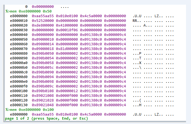

after writing i had read the location it is programmed so how to find where it is hanging

Hello agxin j,
If you have the debugger already connected, you could read the Reset control word status registers (DCFG_RCWSRs) at offset E_0100. And you can use debugger to debug U-boot.

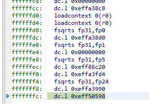

jagxin
hello mam
                with my current rcw the pc value shown in the dis assembly window is this  do we have to place any instruction in the pbi after the location 0xeff50598 it is hanged here

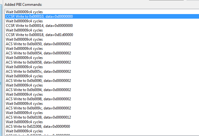

jagxin
hai madam
                      while creating rcw what should be done with pbi we have to include crc or can we leave the pbi as blank
3,452 Views
jagxin
Hai madam
The following comments are there in pbi of the evm do i have to add the same in my rcw also
what are this commands for

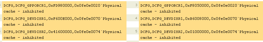

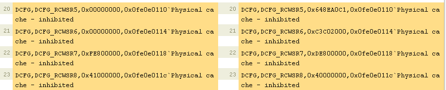

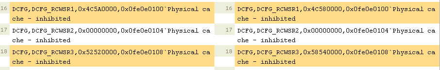

jagxin
dear madam ,
These are the configuration registers that are differing between evm and And our sbc card
left -evm right -sbc
but the rcw is read by the processor if we connect attach in debugger do we get where it is hanged ?
