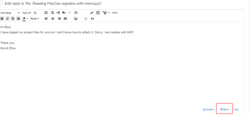

davidzhou
Contributor V
Hi Alice,
I have zipped my project files for you but I don't know how to attach it. Sorry, I am newbie with NXP.
Thank you,
David Zhou
763 Views
Hi David,
Please attach it as this :

davidzhou
Contributor V
I clicked Actions button, there is no Manage: Delete/Edit, etc. The only action available is Mark As Correct.
David
763 Views
ello David,
I don't know why your side is like that , on my side ,it is
then click Actions , it can show Edit.
