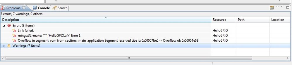

The testing goes very well, and the hello world application is soon complete. There are three building configurations for this  project: IntRam, IntFlash_Debug, and IntFlash_Relase.  I was first trying to build the application under IntFlash_Debug configuration, and the process went well. The binary was successfully created. The binary was downloaded to the target board and executed as expected. However, trouble came out when IntRam configuration was selected. The building process failed at link stage. The following is the error details from CodeWarrior.
"Link failed: Overflow in segment: rom from section: .main_application Segment reserved size is: 0x00007be0 -- Overflow of: 0x00004e68"

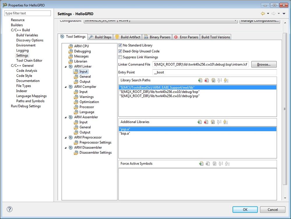

It looks like a link script issue. As I was not familiar with CodeWarrior, it did take some time to locate the link script file.  From the menu: Project->Properties->C/C++ Build->Setting, you can find the link command file location. The following is the picture:
Then opening ${MQX_ROOT_DIR}\lib\twrk40x256.cw10\debug\bsp\intram.lcf,  the code area size is defined there as 0x00007BE0.
MEMORY {      vectorram    (RW): ORIGIN = 0x1FFF8000, LENGTH = 0x00000420  # SRAM - Vector table      rom              (RX): ORIGIN = 0x1FFF8420, LENGTH = 0x00007BE0  # SRAM - Code + Const data      ram              (RW): ORIGIN = 0x20000000, LENGTH = 0x00008000  # SRAM - RW data      ...
After check the binary, it seems the code size should be 0x0000CE68, so I changed the initram.lcf file as following:
MEMORY {       vectorram    (RW): ORIGIN = 0x1FFF8000, LENGTH = 0x00000420  # SRAM - Vector table      rom              (RX): ORIGIN = 0x1FFF8420, LENGTH = 0x0000CE68 # SRAM - Code + Const data      ram              (RW): ORIGIN = 0x20005288, LENGTH = 0x00002D78 # SRAM - RW data      ...
