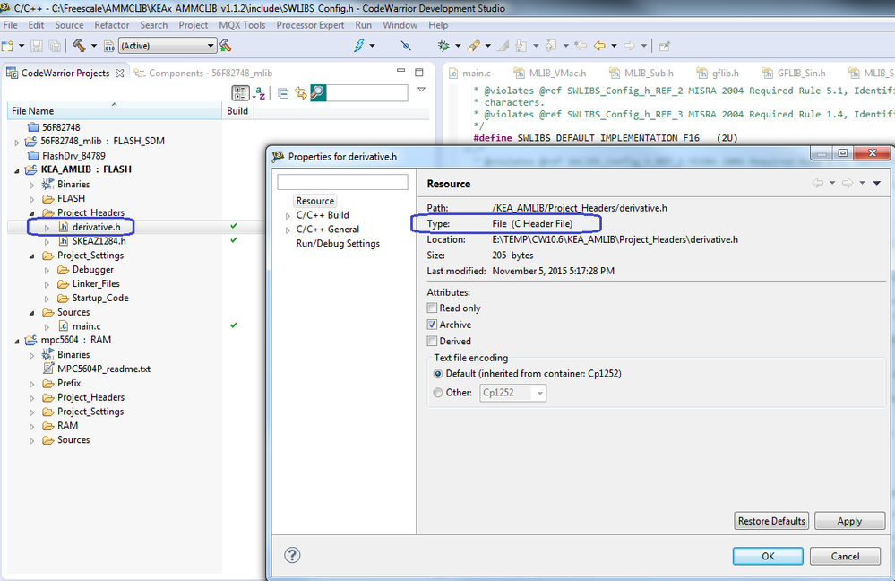

Hi.  I am trying to move an application over from classic CodeWarrior to CodeWarrior for MCU.  I have done this a couple of times with no issues, but have run into a strange problem with the latest one.  When trying to compile, it flags an error in every line of one of the header files, even if it is a comment line.  The errors appear as if the compiler is treating the header file as an .asm file.  Has anyone seen this? Thanks, Keith.

Thank you for the offers of help, but I believe that I discovered the source of my problem.  I mistakenly listed some includes for .c header files in the vectors.asm file.  When it compiled it apparently picked the top include file listed, and tried to compile it as an .asm file.  When I deleted the includes the problem did too.  Many thanks for the assistance.

Hello Keith
Could you please right click on the head file and select ‘Properties’, is it a C head file?

hkeithkidd
Hi Xin,
Thank you for responding.  Yes, the file does show up as a C header file when you look at the properties.  Currently, I am rebuilding the project from the start in an effort to try to determine at what point I start having this problem.  It is the craziest thing I have come across.
