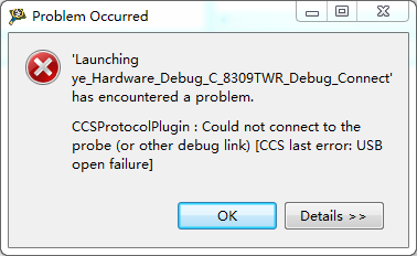

I'm trying to set up a USBTAP to use with Codewarrior(10.0.2).  The host is windows 7(64bit), and the target is an TWR-MPC8309. The RX/TX LED is  flashing GREEN at a regular rate and the "RUN/PAUSE" LED is solid RED.
 I want to download the project to the target. Then a problem occurred, pops
"          'Launching ye_Hardware_Debug_C_8309TWR_Debug_Connect'  has encountered a problem.     CCSProtocolPlugin::Could not connect to the probe(or other debug link)[CCS last error:USB open failure]    ".

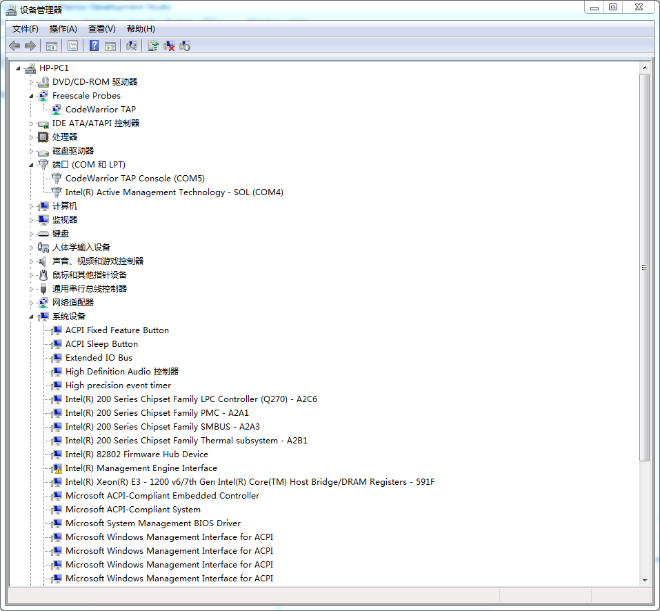

I have gone to ...\CW\PA\CCS\drivers\usb\ and checked the readme.txt file. The driver seems to be installed
Thanks in advance!

Hello Xian Zhang,
Recently we only release the new product CodeWarrior TAP to customers, which integrates both USB and Ethernet ports. I think you should use this new product CodeWarrior TAP rather than the old product USB TAP.
CodeWarrior 10.0.2 doesn't support CodeWarrior TAP, I suggest you consider the following options for MPC8309.
1. Please use CodeWarrior for PA 10.5.1, which could be downloaded from CodeWarrior Dev Tools for Networked Apps|NXP .
2. Please use CodeWarrior 8.8+Patch 8.8.6, which also could be downloaded from the above link.

xianzhang
Hello Yiping,
Thank you for your answer .I have tried CodeWarrior for PA 10.5.1, but it occurrs another problem: " CCSProtocolPlugin : Failed to correctly configure the JTAG chain ".
For this problem,I imported the JTAG chain file named "8309TWR_HRCW_jtag.txt" in the Debug configuration. However , such problem still occur. Do you have any solution?
