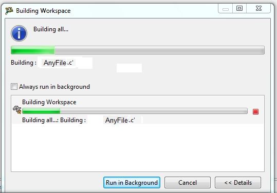

SecondTechCo
Has any one else used Codewarrior 10.4 and experienced a frustrating number of attempts to clean your project only to have it lock when compiling c files.  After that we kill the process, rerun clean and it gets a little farther into compiling.  Sometimes it takes 4 or 5 cleans before it makes it all the way through.  Its not our machines or project because eventually it makes it through and it happens on more than one PC.
This is very frustrating

TICS_Fiona
CodeWarrior v10.x based on a new eclipse platform which has more background operation than classic CW during compiling and debugging. That's the major reason that causes the slow speed. I attached a document which shows how to improve its performance. In addition, '.metadata' in Workspace folder may be larger and larger because it stores all its workspace settings and files. If your CodeWarrior gets abnormally slow, please remove this folder, and restart CodeWarrior. The next version v10.5 and v10.6 are stability release, which will improve performance and stability.

SecondTechCo
Its not the slow speed that is the real problem, Its the hangup in the builds.  When it reaches the stopping point in the list of files its building, it wont come back if you waited hours.  You have to kill mingw32-make.exe or cancel and then retry clean

BlackNight
I know that in the past cygwin caused problems: somehow the cygwin make was called and crashed or caused other strange effects.
- Have you installed the software into a folder where you have full access (e.g. C:\Freescale\CW MCU v10.4 as proposed by the installer)? if not, copy/move it there.
- Maybe it makes a difference if you run CW as administator (run as > administrator)
- if this is caused by the mingw32-make: CW is using the one in C:\Freescale\CW MCU v10.4\gnu\bin.
  There is an older version of it in that folder: you might give a try and rename the make mingw32-make so it runs the older version.

SecondTechCo
We are still getting the Lockup problem.  I believe the person who mentioned the background operation might be spot on.   However we are trying a few more ideas.   We set our windows to run the software in WIndows 7 Compatibility mode.  We also set it up to run as administrator even though the person logged onto the pc is administrator.  We tried old versions of mingw32-make.  They all lockup on multiple machines.

ZhangJennie
it seems that there are some problems with your workspace configuration. removing the .metadata folder in the workspace and then re-start CW might help. if the problem still remains, then, could you please upload your project and a screen-shot for further investiagation?

SecondTechCo
I did remove the metadata folder and retried.  It didn't help.
The screen shot is simple.  The windows comes up and says build all.,  Its attached.  I did change the c file name in the window for privacy.  Its in the windows below.  I couldn't possibly load my entire project for IP reasons.   However, its not project specific and has worked this on all of our machines since 10.0.   Its way worse with 10.4.  Often it takes 4 cleans to go through.   I could load one of your sample projects but they all do the same thing and you already have those.
