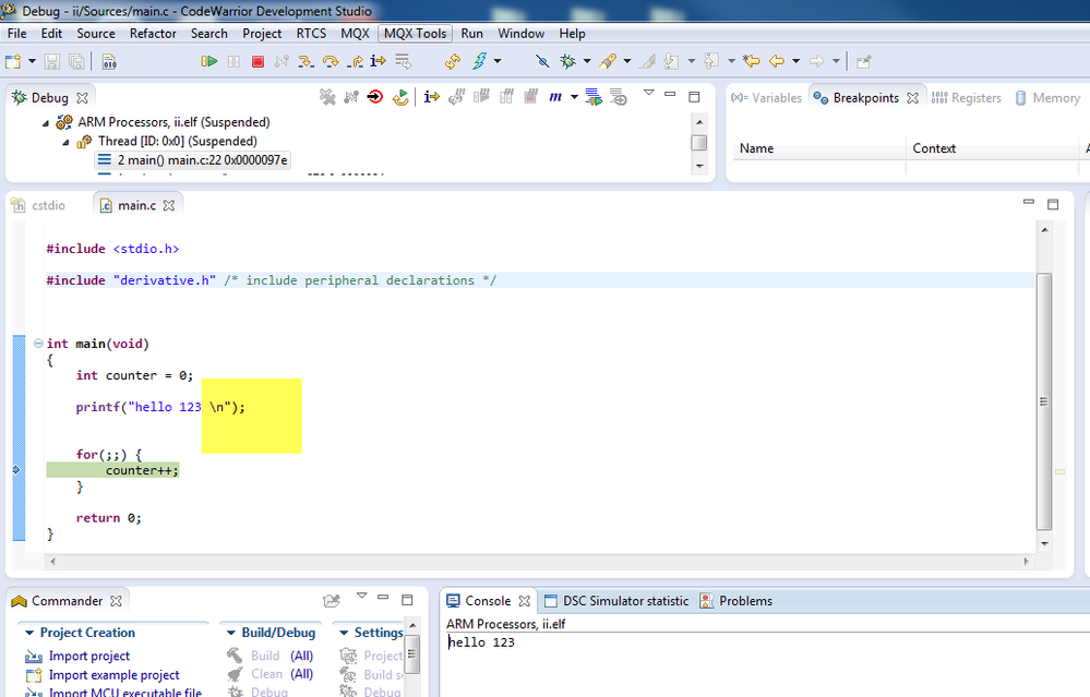

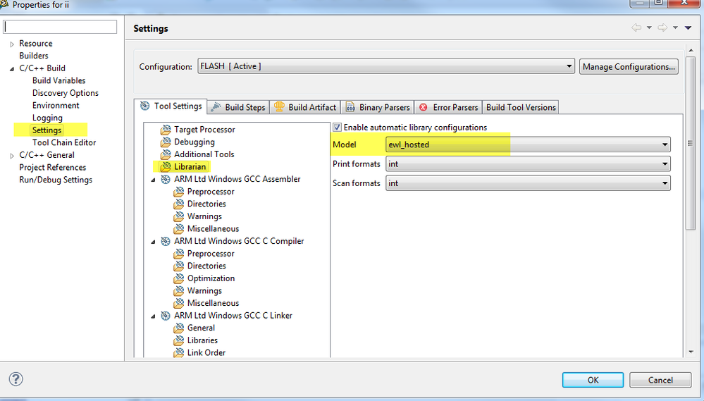

if you want to use printf(), please pay attention to these points:
1. we need add
#include <stdio.h>
in your project.
2. if you want to print to console, choose ewl_hosted library model
3. "\n" is necessary to be added to the end of the string that we need printed out:

Thanks ZhangJennie.
Yes I wanted to print in the console. The output was displayed in the console after changing the settings to ewl_hosted.
