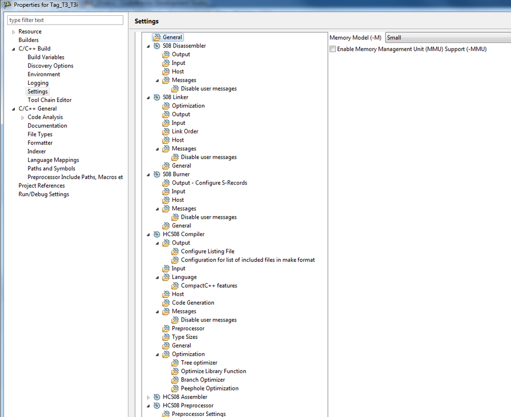

ronen_aharoni
I have port CodeWarrior 5.1 project to CodeWarrior 10.6 and I forgot to enable floating point so I am getting the following error
ERROR L1822: Symbol _FUFLOAT in file
Is there way to change project setting to enable floating point or I have to create new project ?

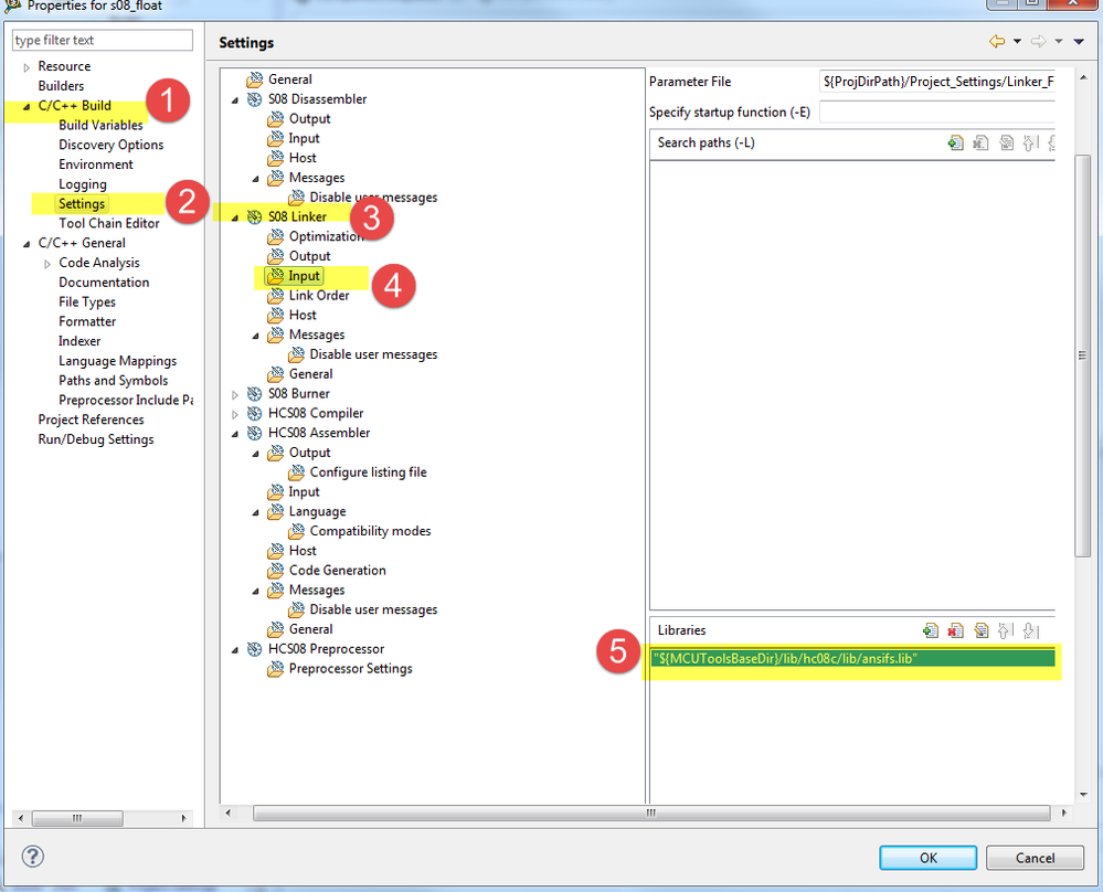

ZhangJennie
Hi Marius,
from your picture, you use HCS08, to enable floating support in CW10, please follow below screenshot captured in properties setting:
here ansifs.lib, small memory model, IEEE32 for both float and double.
for more lib information, see attached readme file.
can this help you?

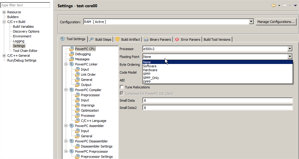

marius_grigoras
From project properties use the settings from bellow picture to modify the FP:
Marius

ronen_aharoni
Hello Marius
Thanks for helping
However I do not see the CPU section so I cannot do the setting as you describe
Best Regard

ronen_aharoni
Thank you Marius
I don't see the CPU section in my project  under setting
