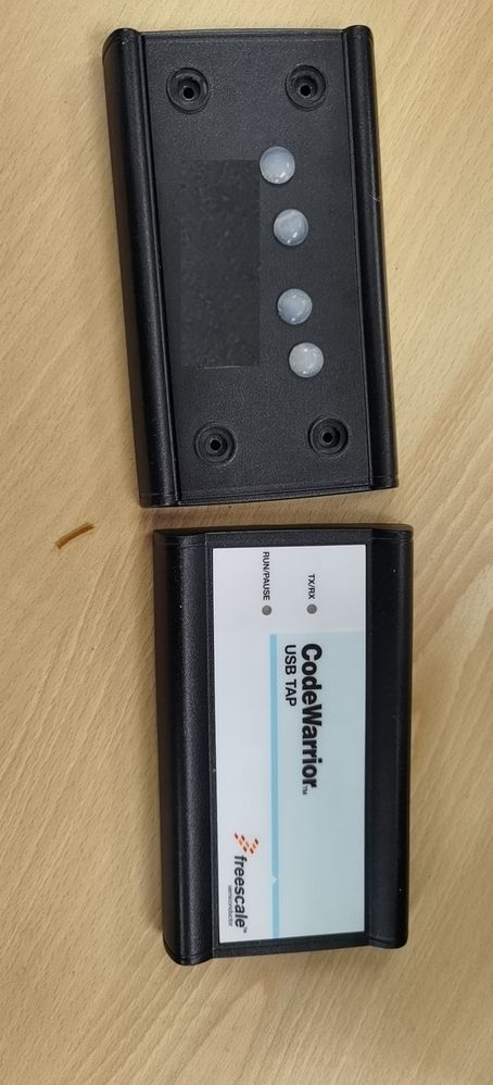

Over the years, we have been using CodeWarrior v8.8 and codewarrior usb tap to program the external flash of mpc8323. However, with the aging and damage of the codewarrior usb tap, we have only one usb tap can work now, so we want to confirm the following problems:
① Is the CodeWarrior USB tap we used in the picture attached stopped production? If the production has been stopped, is there still any way to buy it?
② If we use cwh-ctp-base-he + cwh-ctp-cop-ye to replace CodeWarrior USB tap, do we need to install other drivers or patch files for the original settings or CodeWarrior 8.8 software??微信图片_20200701125004.jpg
Yes.
NXP does not sell obsolete products - try to search third-party vendors.
No.
