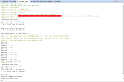

Hi I follow all the steps from the link and i cant seem to find a way to save the Debugger Shell Output result from the flash into a text file. I followed the next solution
https://community.nxp.com/t5/CodeWarrior-for-StarCore/Log-Console-Output/m-p/183525/highlight/true
and
https://community.nxp.com/t5/CodeWarrior-for-MCU/TCL-Script-in-Codewarrior-for-MCU/m-p/295555/highli...
also
https://www.xmodulo.com/how-to-save-console-output-to-file-in-eclipse.html
But it does not save.
That is the information i want to save into a txt file once it is done with the Flash Operation.
Is there any other way on how to save the Debugger Shell output?

Hi Adrian,
You can use the "log" command in the debugger shell to output the data into a specific file location.
Felipe
