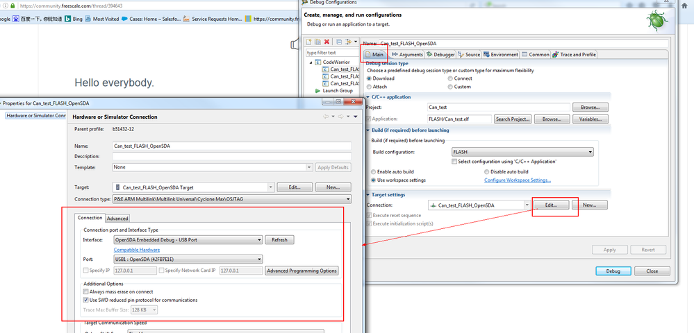

Here i can help you check the configure On cw.
On cw , please select Use SWD option :
Please also take a screenshot about the configuration on your side .
Hope it helps

lucaag
Thank you very much Alice, you're very kind.
I attach some screenshot of my configuration, and the error message that
CW gives back.
I double checked the HW and everything seems to be ok. I see the reset
pin moving before I connect the programmer, but since it starts, I see
the signal stable. I've also verified the CLK end DATA arrive on the
board connector.
Where do I find the SWD option in CW environement?
The project has been created with the standar wizard, using the option
of "Bareboard Project"
Thank you in advance,
Luca

Hello Luca,
I recommend you first create one simple project to test ,
and please check here :
Alice
