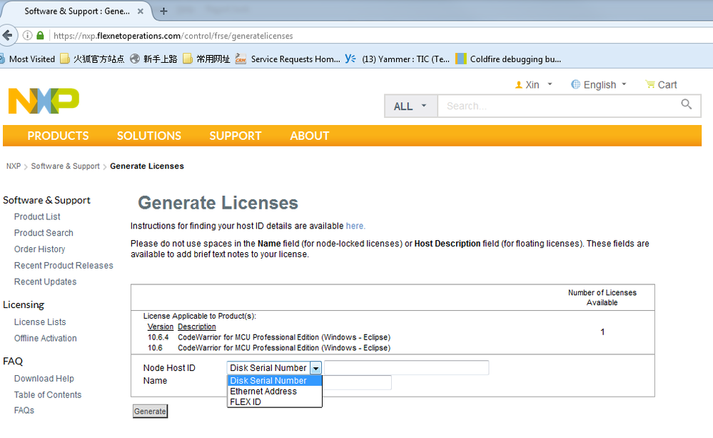

On the Generate Licenses page, there are only two choices: Disk Serial Number and Ethernet Address.  Nothing for USB dongle.

For the node-locked CodeWarrior Suite, user can choose Flex ID and key in his dongle ID when generate the license file as below:
Our new web license system was launched in December 2014. Unfortunately for all license files generated before this date, you will not find them under your account.

As I stated earlier, FLEX-ID is not an option shown on the Generate Licenses page.  Only the Disk Serial Number and Ethernet Address appear as options.  What does this mean?

Is the license type of your CodeWarrior Suite floating license?  For floating license (e.g CWP-PRO-FL_1-*******), there is no FLEX-ID in the selection list when generate license online.  Only for node-locked license, user can select FLEX-ID and key in his dongle ID.  By default, the floating license is locked to the hard disk ID or Ethernet Address of server.

I see that is the problem -- we originally bought a floating license, later converted to USB dongle.  Wondering how the licenses were generated after that because all the licenses (CW6.3, 7.2, PA8.8, 10.x) contain the FLEX-ID for host spec.  Can I generate a HD license for CW10.6 and then replace host with the FLEX-ID?

You can only get the floating license online for your CodeWarrior Suite CWP-PRO-FL_1-*******.  Floating license is locked to hard disk ID or Ethernet Address of server.   If you need a node-locked license which is locked to the local machine’s disk ID or Ethernet Address, or dongle ID, please summiting a case.  Our license team will handle it. This doc shows how to summit a case:
How to log an issue in Case system instead CRM (Service request - not used anymore)?
In addition, I sent you temporary license for CW10.6 by email, you may use it before get your dongle license.
