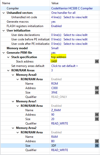

Hi all,
I'm trying to use STACKTOP attr to my MC9S08MP16 stack. However, when I try to to compile, only get an error:
For reference, my linker file is attached.
Anyone lnows how to solve that?
Thanks!
Original Attachment has been moved to: Project.prm.zip

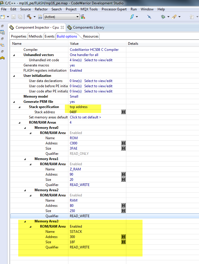

ZhangJennie
If you want to use STACKTOP, we need define a segment for stack and pace predefined segment SSTACK into it. see below steps of using  STACKTOP
Hope this helps.

wnoliveira
Hi Zhang,
Acctually, it's not what i'm looking for. In your case, you predefine a space for STKRAM (from x300 to x48F), however when I use processor expert to generate a similar configuration, it doesn't define any size for STACK. It just let the stack to be placed in all remanescent space of RAM segment.
In the project that i've attached, I don't use processor expert (because of very density code, almost fill uC ROM), but testing it like I said works fine.
I just doesn't understend what is the difference.
If you can test it, try to set processor build options like that:
Thank you.

ZhangJennie
if you want to use stacktop with processor expert, you need fine a segment for it. see below
