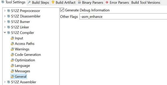

Recently we helped a customer resolve a question related with “asm_enhance”command line option usage. It’s strange there is no documentation of this knowledge in CodeWarrior help manual. After many discussions with development team, it gets clear to me. So I wrote an article on this topic for sharing.
“ -asm_enhance” option is added in ColdWarrior10 /CodeWarrior11 “compiler setting”, “General”, “Other Flags”:
"-asm_enhance" command line option can be used for two distinct aspects:
  • Enabling inline assembly data optimizations
  • Enabling stack effect computation through inline assembly code.
These two aspects were all gathered under the same option because they both are referring to enhanced inline assembly – i.e. inline assembly code that gets handled almost as C code).
Thank for the great support from Bogdan Ditu .
For more information on -asm_enhance, see attached document.
