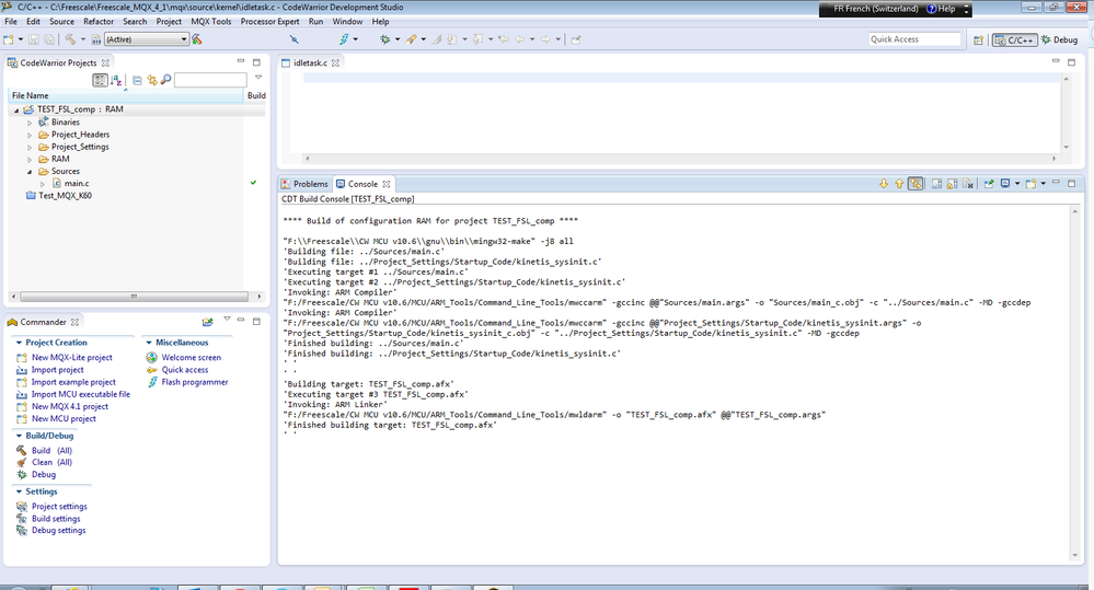

Hi Stefano,
I think you're using MCU V10.6.
I don't think there is a problem with the compiler option or not.
In all case the duplicated variable is checked at link phase.
Under Eclipse, by default the "Problems" component is displayed.
        this component is not providing lot of information regarding the problem.
When there is an error (in Problems Component) when you build a project, to have more details, I recommend to switch to the Console component.
The console component will capture all exchange messages sent to (command line tool) and generated (information, warning and error) by tools (Assembler, compiler, linker etc ...).
In this dialog you will have exactly the error reported by the tool.
