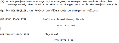

Looking at the Welcome_CW_MCUs text document in CWMCUV61RN it mentions the following:
[Welcome_CW_MCUs -> General Limitations]
Could you please try the above workaround in case you are using MC8S08QE?
