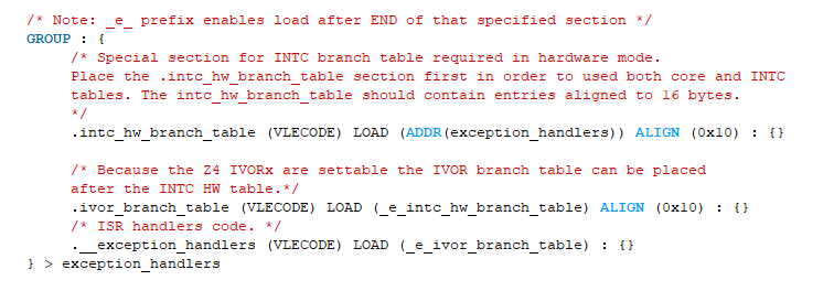

IDE is codewarrior 10.5.  Processor is MPC5644A.
Errors(3 item)
Linked failed.
Linker command faile output section '.ivor_branch_table' has a type or input which is incompatible with section '.ivor_branch_table' in file 'C:\workspace\w20\FLASH\ivor_branch_table_c.obj'. Change the type or add an input for this.
mingw32-make:***[w20_prj.elf] Error 1
Wating for ideas.

could you please show me, how your linker file looks like, especially ivor_branch_table section and also how the ivor_branch_table.c looks like?
In the figure below, there are correct files shown.

Hi,Martin,
       In my project, the ivor_branch_table section and  the ivor_branch_table.c were created by the IDE 10.5 . I've solved that link error by deleted the (VLECODE) that was located in the GROUP as you showed in "exception_handlers". Actually , I still don't know the reason. And, my interrupt service program still can not run correctly.
       The whole project includes my RTI_led project ,bootloader project and host computer. Now ,the problem is my interrupt service program in RTI_led project which is run by bootloader can run only sevral times .Then ,it will die. I guess the reason is ivor_branch_table which is exist both in bootloader project and RTI_led project , so two ivor_branch_tables will cause conflict. What do you think?
