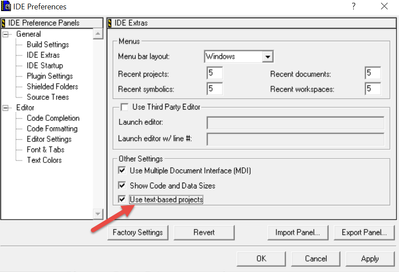

ZhangJennie
HI
Please enable "use text based project" , reopen CodeWarrior. then import my demo project again,
Have a nice day,
Jun Zhang

ZhangJennie
HI
Have a nice day,
Jun Zhang
