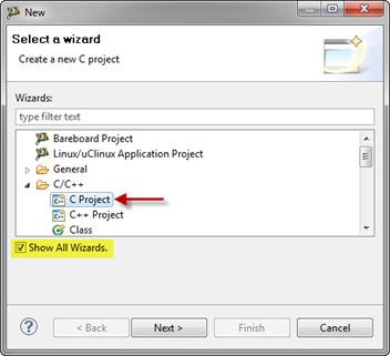

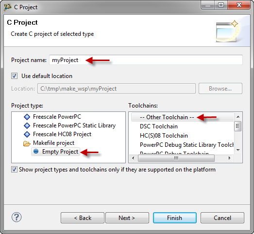

  1. 2-      Launch Eclipse and create a new empty project
                File ¦ New ¦ Other …
Enable Show All Wizards and select the C Project (which is otherwise hidden), pressing Next.
Click OK
Specify the project name, select an Empty Project under Makefile project with — Other Toolchain — and press Finish:
Now I have an empty project

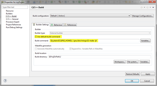

Using Project ¦ Properties specify my Build Command:
                ${system:ECLIPSE_HOME}/../gnu/bin/mingw32-make -j6

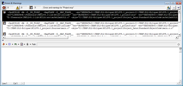

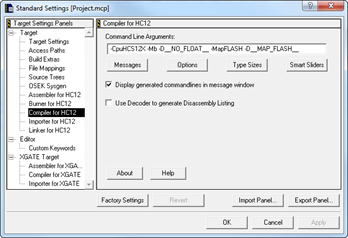

  1. 1-      Generate the Commandlines used by HC12 v5.1 to build the project.
By this way you will have the options and other paths used for compiler and linker to build the project.
We can use these information to create the makefile.

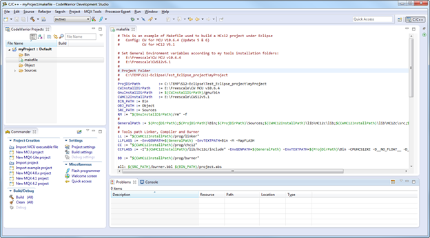

  1. 2-      Create the makefile with the menu menu File ¦ New ¦ Other... ¦ General ¦ File
An empty makefile is created.
You need to create your makefile according to your project.
For more details we recommend to refer to the link:
http://mcuoneclipse.com/2012/02/13/make-my-make-with-eclipse-and-mcu10/
This is the makefile created for this example.
The makefile created contains 2 operations:
                                all -> build the project and generate Srecord files
                                clean -> remove all generated files

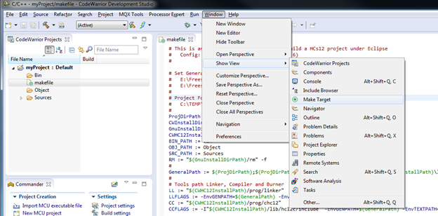

  1. 3-      Create 2 make targets
for all and clean operations with the "Make Target" under Window ¦ show View
Now I can build the project using HC12 v5.1 tools (compiler/Linker) under Eclipse project

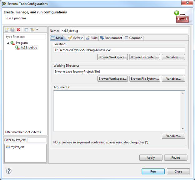

Phase 3: Add External debugger to debug hc12 application
HC12 V5.1 is using an external debugger named Hiwave.
This tool is using a config file named .ini.
To use HiWave under Eclipse project, we need to define it as external Debugger.
By the Run menu click on External Tools ¦ External Tools Configuration…
Run will launch the Debugger and the project.ini file will be generated in the \Bin folder
                You can edit the ini file and use the info provided in the .ini file of HC12 V5.1 project

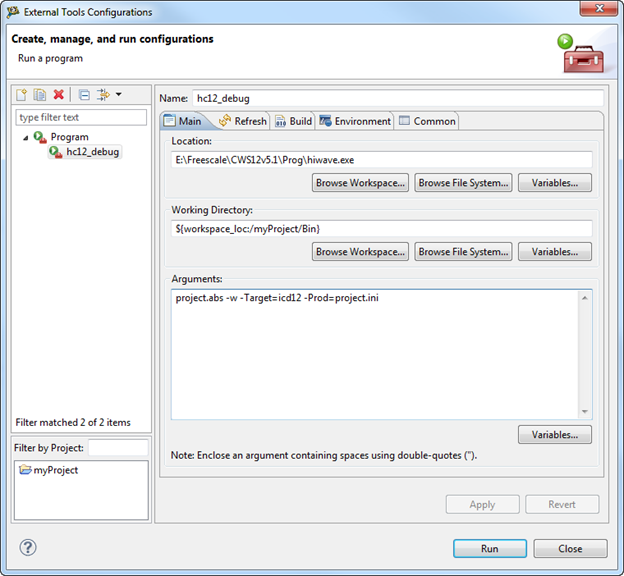

To use these settings, add the Arguments:
                project.abs -w -Target=icd12 -Prod=project.ini
Now the debugger is launched and application loaded on board with Multilink Interface.
