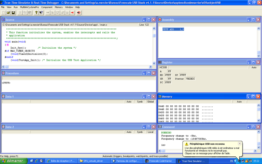

alexismercier
Hi Weiping,
thanks a lot for your help. The program compile but my 60 stays as an unknown device and windows tell me that it's work normally

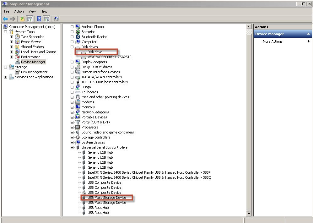

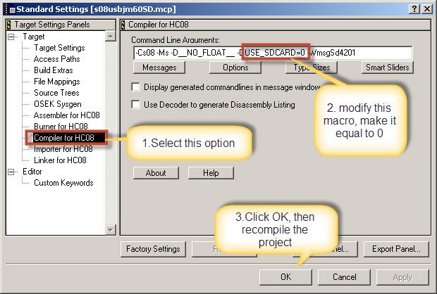

ok, if you want to use CW classic, please modify the compiler option as below,  after doing that the project can work.
1. Select standard setting
2. Modify the compiler option
3. After download the program to DemoJM60, we can see the device in hardware manager.
