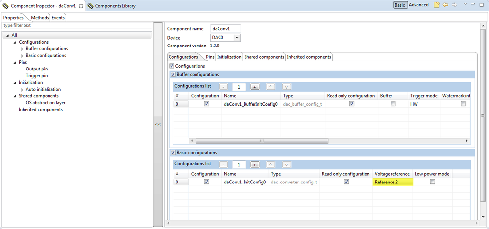

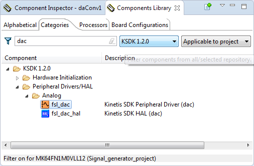

  • adding analog component fsl_dac peripheral driver to project
  • setting Voltage reference - Reference 2 for dac component (daConv1:fsl_dac)

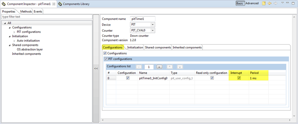

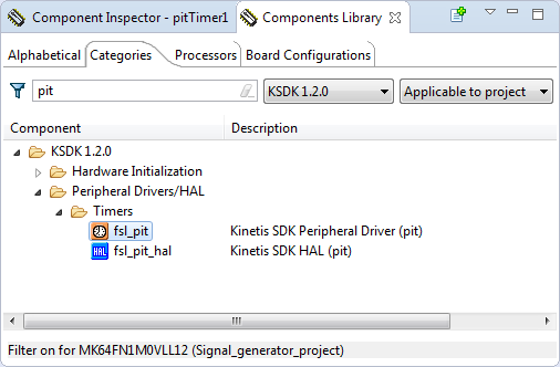

  • adding timer component fsl_pit peripheral driver to project
  • setting period on 1 ms and enabling interrupts for timer component (pitTimer1:fsl_pit)

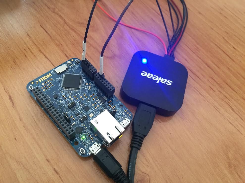

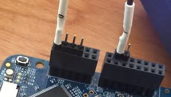

  • FRDM-K64F with SALEAE

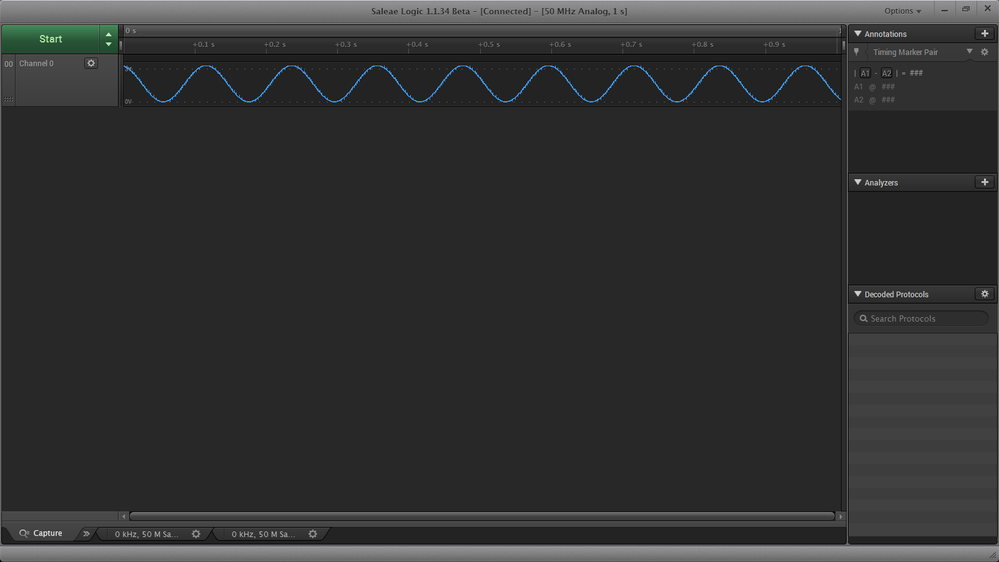

  • sinusoidal output
