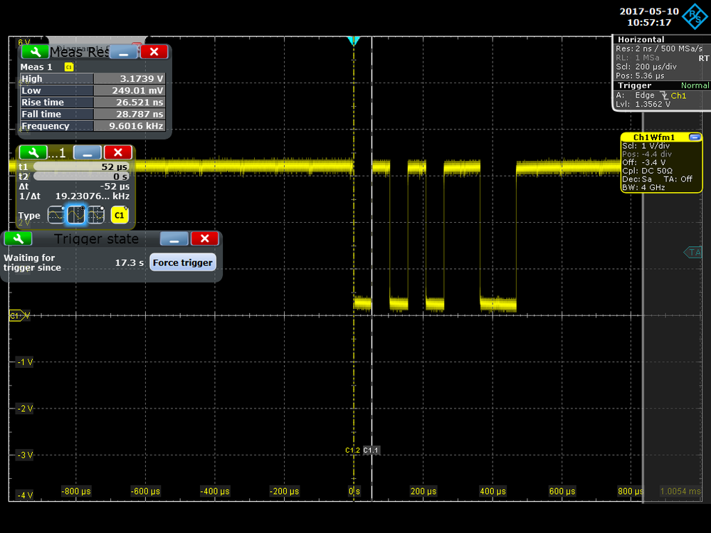

gluo
There was no any errors after the correct baud rate was set.
We have repeated the testing. It looks that you are correct on the possible impact of BRK on autobaud.
We monitored the input signals with a scope.
It looks that UCC7 did declare the reception of bytes and BRKs that were not sent by DCE at all (confirmed with scope), although we did not see any un-expected BRK or un-expected  characters  to UCC7 Rx through the scope.
For example,
  • one byte (0x35,  for  ‘5’ ) from DCE was declared at UCC7 as three Rx events with bytes 0x1c 0xfc 0xfc. (see Test Case Group 1)
  • one byte (0x41,  for ‘A’) from DCE was declared at UCC7 as one  Rx event with byte 0x1c and a BRK event (see Test Case Group 2)
 It was found in the following two group of test cases that
  • a specific set of  characters seems to always  trigger correct BRGC baud rate locking (Test Case Group 1), and
  • an another specific set of  characters (Test Case Group 2) always  trigger incorrect BRGC baud rate locking.   In these cases, the un-existing BRKs from DCE were always reported by UCC7 UCCE register.
-------Test Case Group 1:   (correct baud locking cases, no BRKs)
DCE(19200)  send Rx single "5" (Screenshot_2017-05-10_05_105717.png)
   UCC7 saw 3 Rx: 0x1c 0xfc 0xfc          locked_brgc=0x1268a (locked_baud:14916)   locked baud close to 19200/ok_translate!

     note from testing:
          characters (4 5, 6, 7, 9, D to I, Q, T to Y, a to o, s to z) triggered corrected BRGC locked baud mostly.
