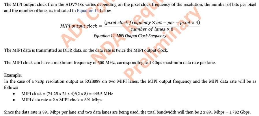

if someone is confused with "pixel clock", "mipi clock lane frequency", "mipi data lane frequency", following is an simple explanation:
and pixel clock can get from this website: VGA Signal Timing
