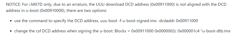

UUU command to download image:
After the boot image is signed properly the image can be downloaded using UUU with following command:
sudo ./uuu SDP: boot -f u-boot-signed.bin -dcdaddr 0x00911000
Using this command ensures the boot image is downloaded at the correct DCD address and thus the image can be authenticated properly.
This is also updated in UUU wiki:
