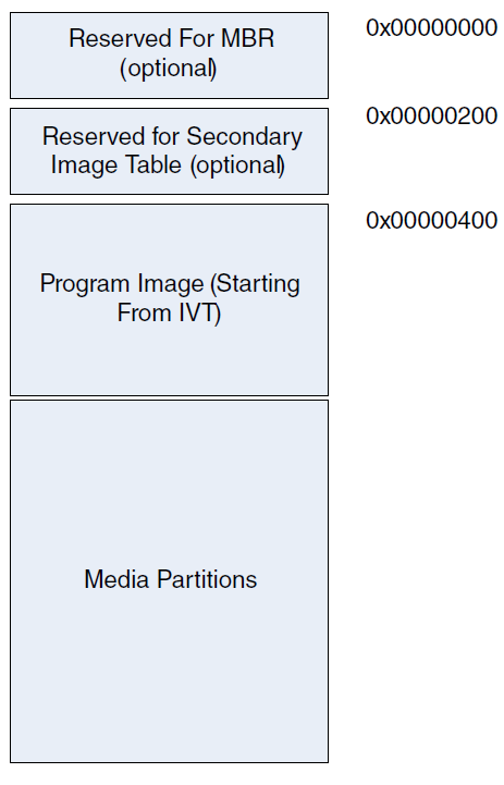

For the secondary image support, the primary image must reserve the space for the secondary image table. Refer to figure 1 below for the layout of the typical structure on an expansion device.
Figure 1. Expansion device structures layout

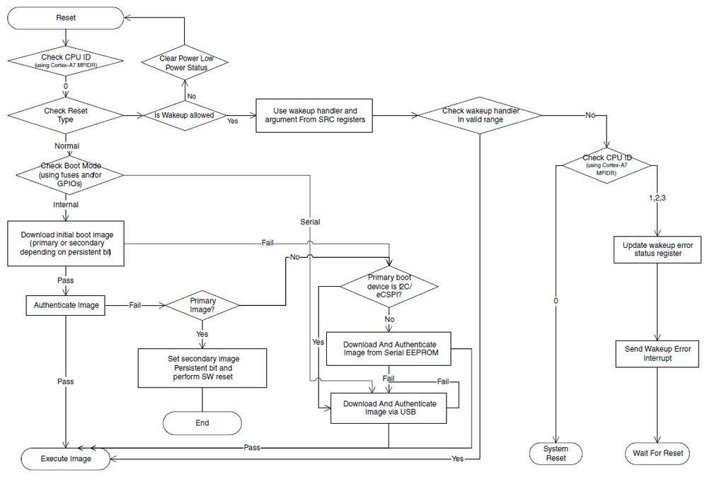

For the Closed mode (Security Configuration Enabled), if there are failures during primary image authentication, the boot ROM turns on the PERSIST_SECONDARY_BOOT bit and performs the software reset.
After the software reset, the secondary image is used. Details in Figure 2 below.
Figure 2. Boot flow (click on the image for zoom)

The redundant boot is used only in correlation with HAB and secure boot. As you can see in Figure 2, the switch between the images is done only if the authentication fails.
The issue is that the redundant boot support is not triggered when the first image's u-boot code is tampered (not the header). This is because the reset operation after the failed authentication is not properly executed. The reset used by boot ROM to switch between the images is a warm reset - this warm reset is not correctly resetting the DDR controller that will impact the final DDR initialization when the DCD will be run for the second time by the secondary image. This is not reproduced when the header is altered, because the DCD is not run and the DDR initialization is not finished. So after the warm reset, the DDR initialization will successfully initialize.

  5. The primary image is downloaded
    1. The DCD is executed and DDR initialization is done successfully
    2. Authentication for the first image fails (because the u-boot was altered)
    3. The persistent bit is set by boot ROM
    4. A warm reset is triggered in order to switch to the secondary image (the warm reset is not correctly resetting/configuring the DDR controller to prepare it for another initialization)
  6. The second image is downloaded (because the persistent bit was set)
    1. The DCD is executed for the 2nd time and DDR initialization just fails hanging in the SoC/boot ROM
